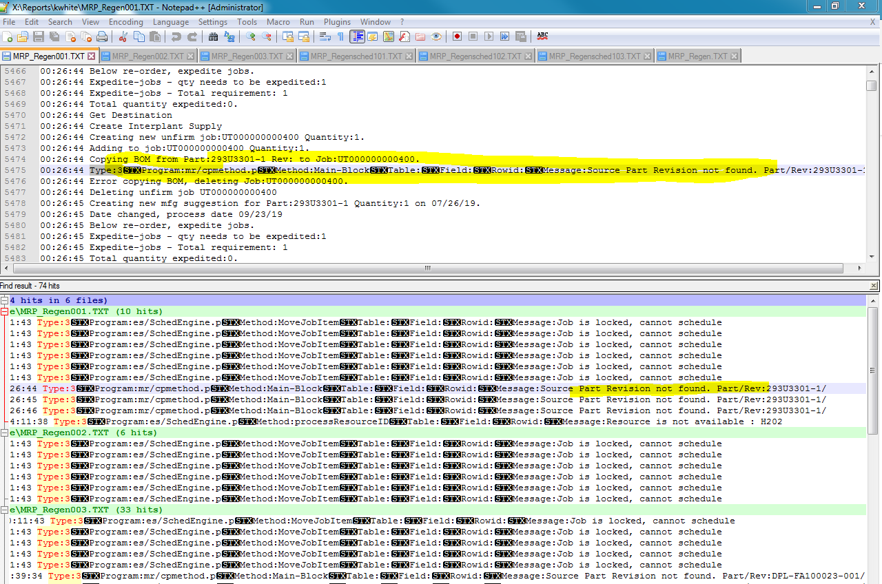

This may be the long way around but we typically look at the main log to see if any parts abandoned then look at the log for those processes to see where it failed. Then I open all the log files in Notepad++ and search for Type:3 (Find in all opened documents) It will give you results below of issues. Now MRP will still run complete with these issues but jobs may not get created or not scheduled. You can then click on each line and dig deeper if needed. I usually send the results out after I polish them up.
Here is a screen shot of my logs…
