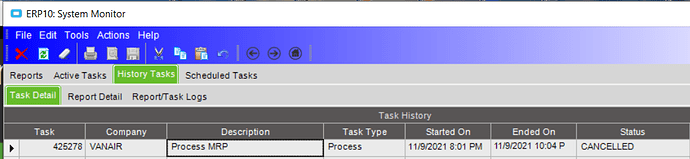

For the past several days our nightly run of ‘Process MRP’ has failed. Historically we were running it in (full) regenerate mode, and that step was taking roughly about 7 hours. Combine that with a few other tasks in our process set and the entire run was lasting 9-10 hours. So we decided to start running MRP in ‘Recycle MRP Jobs’ mode during the week (overall execution duration dropped to 4 hours) and only run full recycle on the weekends.
A few weeks back we updated to 10.2.300.40. Since then we’ve had several executions where the ‘Process MRP’ step stops at 1-2 hours. System monitor offers no detail. The server event viewer essentially just says ‘PROGRAM CANCELLED’. So I’m having difficulty identifying the cause for the interruption.

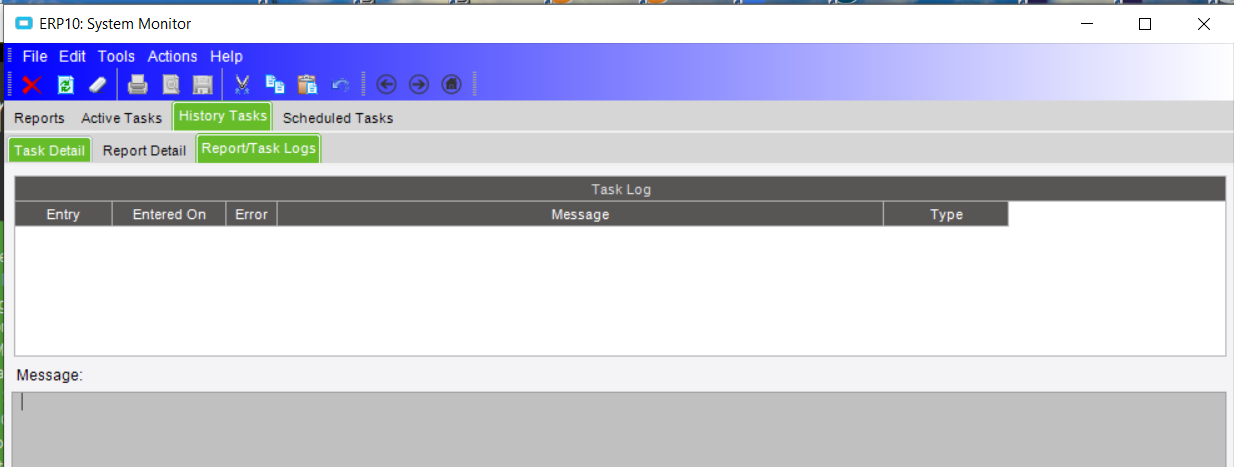

Last night logging was turned off inadvertently (I was attempting removing a step from our normal process set that has worked in the past) and we only keep the previous night’s logs. That said, normally when the interrupt is due to a part, the system monitor indicates which part. The past few nights have produced the following signs:
System Monitor:

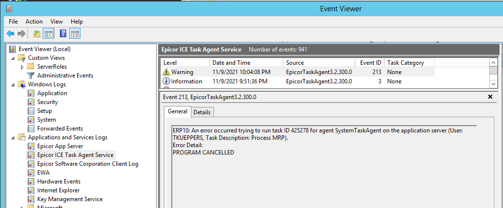

App Server Event Log:
Haso: I will review the additional sources you’ve indicated.

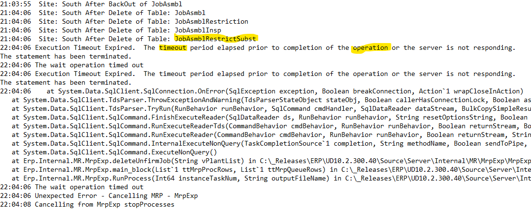

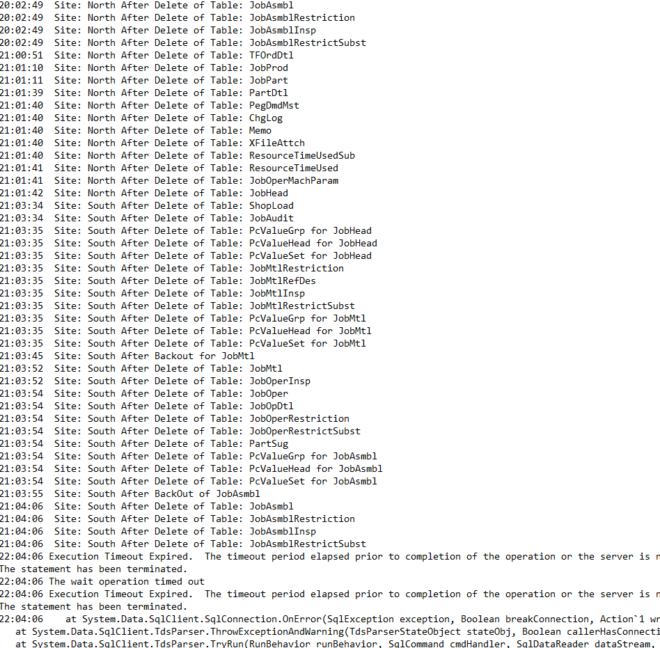

We did have the log enabled, but it only logged in MRPLive. It appears that this failed during the step when it would delete the TFOrdDtl.
Here is the error from that log:
22:04:06 Execution Timeout Expired. The timeout period elapsed prior to completion of the operation or the server is not responding.
The statement has been terminated.
22:04:06 The wait operation timed out
22:04:06 at System.Data.SqlClient.SqlConnection.OnError(SqlException exception, Boolean breakConnection, Action1 wrapCloseInAction) at System.Data.SqlClient.TdsParser.ThrowExceptionAndWarning(TdsParserStateObject stateObj, Boolean callerHasConnectionLock, Boolean asyncClose) at System.Data.SqlClient.TdsParser.TryRun(RunBehavior runBehavior, SqlCommand cmdHandler, SqlDataReader dataStream, BulkCopySimpleResultSet bulkCopyHandler, TdsParserStateObject stateObj, Boolean& dataReady) at System.Data.SqlClient.SqlCommand.FinishExecuteReader(SqlDataReader ds, RunBehavior runBehavior, String resetOptionsString, Boolean isInternal, Boolean forDescribeParameterEncryption, Boolean shouldCacheForAlwaysEncrypted) at System.Data.SqlClient.SqlCommand.RunExecuteReaderTds(CommandBehavior cmdBehavior, RunBehavior runBehavior, Boolean returnStream, Boolean async, Int32 timeout, Task& task, Boolean asyncWrite, Boolean inRetry, SqlDataReader ds, Boolean describeParameterEncryptionRequest) at System.Data.SqlClient.SqlCommand.RunExecuteReader(CommandBehavior cmdBehavior, RunBehavior runBehavior, Boolean returnStream, String method, TaskCompletionSource1 completion, Int32 timeout, Task& task, Boolean& usedCache, Boolean asyncWrite, Boolean inRetry)
at System.Data.SqlClient.SqlCommand.InternalExecuteNonQuery(TaskCompletionSource1 completion, String methodName, Boolean sendToPipe, Int32 timeout, Boolean& usedCache, Boolean asyncWrite, Boolean inRetry) at System.Data.SqlClient.SqlCommand.ExecuteNonQuery() at Erp.Internal.MR.MrpExp.deleteUnfirmJob(String vPlantList) in C:\_Releases\ERP\UD10.2.300.40\Source\Server\Internal\MR\MrpExp\MrpExp.cs:line 1988 at Erp.Internal.MR.MrpExp.main_block(List1 ttMrpProcRows, List`1 ttMrpQueueRows) in C:_Releases\ERP\UD10.2.300.40\Source\Server\Internal\MR\MrpExp\MrpExp.cs:line 2644
at Erp.Internal.MR.MrpExp.RunProcess(Int64 instanceTaskNum, String outputFileName) in C:_Releases\ERP\UD10.2.300.40\Source\Server\Internal\MR\MrpExp\MrpExp.cs:line 922
22:04:06 Unexpected Error - Cancelling MRP - MrpExp
22:04:08 Cancelling from MrpExp stopProcesses

In this case, when I review the log, what I see is that there must be “operations” within the process… and it appears to me that those operations have a timeout of 1 hour. We’ve been seeing it timeout at 1 hour when it fails in full regen mode, but last night’s failed at 2 hours. I believe that’s because the first operation completed in just under 1 hour, therefore did not timeout (see screenshots below)… and the process moved on to the next operation. I don’t know if I am using the right terminology, but I see the word “operation” in the error.
Does anyone know where there might be a timeout setting that controls these “operation” timeouts? I checked web.config and I don’t see one that looks like it would control this.

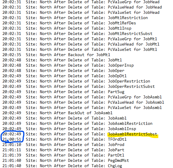

Another good question would be why does deleting the TFOrdDtl table take close to an hour. I found this in the archives. It’s over my head, though. @tkueppers maybe you can make sense of it?

aha! The query timeout is set to 3600 (60 seconds x 60 minutes). It’s failing to execute the delete query and then timing out. I bet this will get us past that timeout problem. I still want to investigate why it is taking an hour to execute… as it should only take seconds… like the other tables.
Right, that’s the doozy.
