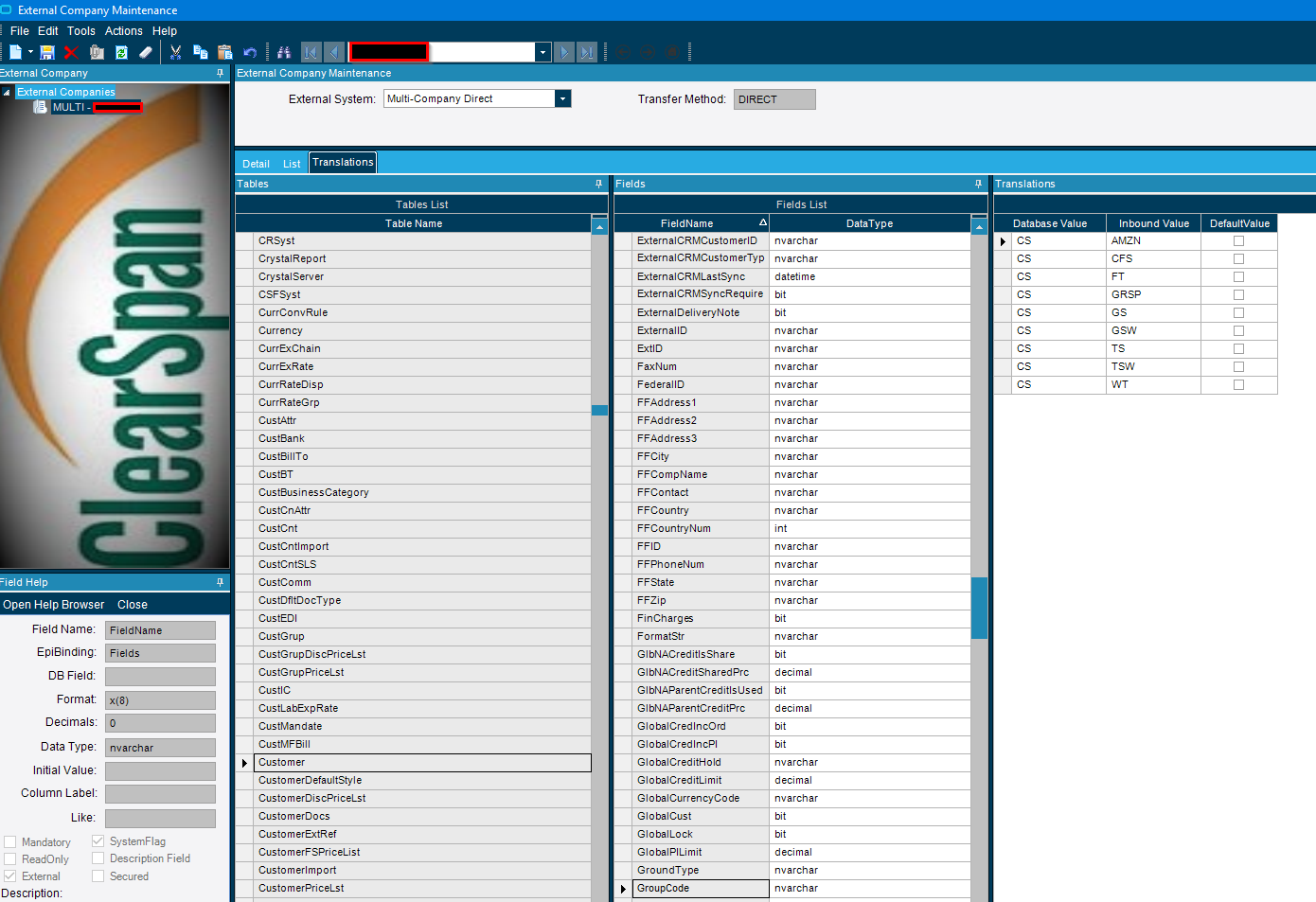

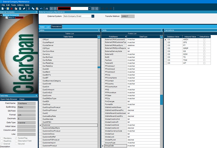

With Multi Company, you can use the ‘Translations’ tab in External Company Maintenance to map fields to be transformed as they go across companies. We use that for ShipVia, TermsCode, Groups, Credit Limit, Credit Hold, FOB, & Tax Region Code. I don’t see why you couldn’t use it to transform part numbers too…
