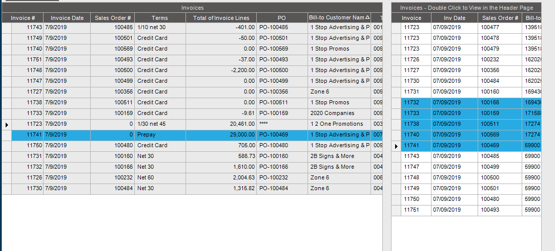

I’ve got it working with this. Now I just have to figure out the opposite which is when it is deselected, deselect the row.

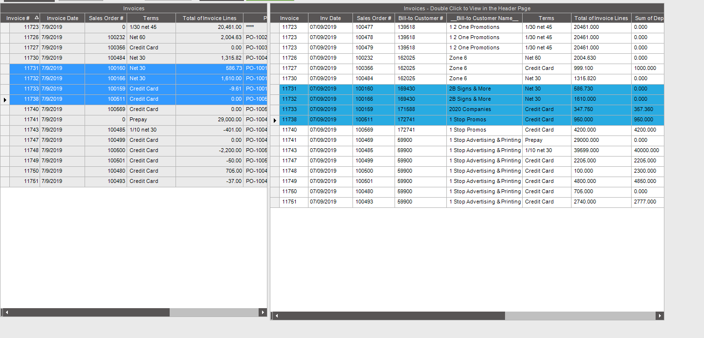

I thought that too, however, when I changed the code to have row.Selected = false; in the else section it deselected every row but the last selected one. It isn’t working properly. I need it to keep all selected rows on the left grid to be selected on the right and only deselect the ones on the left that I deselect on the right.
That code is here:
	private void gridGSInvoices_AfterSelectChange(object sender, Infragistics.Win.UltraWinGrid.AfterSelectChangeEventArgs args)
		//foreach(var selected in gridGSInvoices.Selected.Rows)
		if(this.gridGSInvoices.Selected.Rows.Count > 0)
				foreach (UltraGridRow row in this.grdList.Rows.GetRowEnumerator(GridRowType.DataRow, null, null))
					if (Int32.Parse(row.GetCellValue("InvoiceNum").ToString()) == Int32.Parse(selected.GetCellValue("InvcHead_InvoiceNum").ToString()))
							row.Selected = true;
					else
Picture of example:
You are looping through and acting only if there are selected rows. If you need to find un-selected rows, you’ll have to do a loop to un-select on un-selected rows. Or do a clear of all selected rows and re-select.

I looked thru that but I don’t understand how to say if a row gets unselected on the right to then perform an action. I don’t want to clear all.
just clear everything before start the loop, then re-select everything in the loop again.

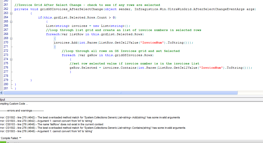

Ive got these errors. Any ideas?
You can either
  • Make the List a List
or
  • Change
invoices.Add(int.Parse(listRow.GetCellValue(“InvoiceNum”).ToString());
to
invoices.Add(listRow.GetCellValue(“InvoiceNum”).ToString());
and
Change gsRow.Selected = invoices.Contains(int.Parse(listRow.GetCellValue(“InvoiceNum”).ToString()));
To
gsRow.Selected = invoices.Contains(listRow.GetCellValue(“InvoiceNum”).ToString());
the second one doesn’t require the value to be converted to a integer, does the comparison as a string.
Scott
Make List<string> to List<int>
For the last error you need to change the name of the row instance
gsRow.Selected = invoices.Contains(int.Parse( gsRow .GetCellValue(“InvoiceNum”).ToString()));
