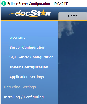

You mayhave separate VM’s (App + IDC + DB) … You can check the Live config. in the Eclipse Server Config:
hope this helps !
