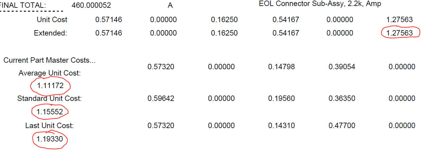

I decided to go back and load/update standard costs for parts and see what that got me… I then printed a BOM Cost Report for a simple item with very parts to see how it was looking. I think I might be losing my mind… The BOM Cost report pulls the Standard Cost from the system right? Somehow I’ve got a bom that has given me 4 different costs…
I believe that’s one of the intended side effects of a BOM Cost report. You are getting the total sum of the components as of this moment. The Part Master cost is not going to get updated unless you do a Cost Rollup on the BOM and post it.
Ok…that makes sense… Thanks! I think I’ve stared at this so much this week and tried to wrap my brain around all the inner workings to the point that logic and reason have deserted me.
Right, so if you have the BOM the way it is intended to be at standard and all of the cost elements for all of the materials on the bill are also up to date, you can roll the cost for the parent part and all associated parts.
Then if you print the BOM cost report it will line up with the cost you see in the part tracker.
we use average cost as well and the material on our BOM cost report is costed using average. Comparing the cost of the part to the actual part cost is challenging though as the BOM cost report essentially rolls the cost from the BOM. The tricky part is if any material has a BOM it will use it and roll that cost…so if you BOM related cost is not accurate vs the actual purchase cost of the part you will have a variance etc.

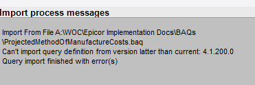

So it’s odd but I cannot import the latest one you posted but was able to import the first one. It could be a version issue? We’re in 10.2.700 upgrading to Kinetic this fall.
It is. I modified this one to change the version inside the file, try this.
If he didn’t do anything advanced, it should probably import.
VersionChangedProjectedMethodOfManufactureCosts.baq (237.7 KB)
