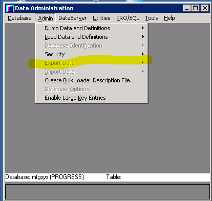

All - Any idea why the Export options in the Porgress Data Admin tool would be disabled?
Ive tried various ways of making the connection (multi-user, single user) With DB and App services runing or stopped, etc…) but no luck getting the Export Data menu item to be enabled.

Likely a restriction caused by the licensing with OpenEdge 10.1b. Do you have an Epicor 9.05 install somewhere with a 32bit install of 10.2a? If so, I would try that as we delivered more licensed modules with OpenEdge at that version.

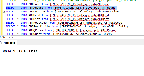

One could also consider using a SQL linked server connection to the Progress database via ODBC, and create series of select * into newdatabase.dbo.tablenamegoeshere from [linkedserver].mfgsys.pub.tablenamegoeshere commands
If one were to run a query like so against an V803410 SQL database
SELECT 'SELECT * INTO ' + TABLE_NAME + ' from [linkedservername].mfgsys.pub.' + TABLE_NAME
FROM INFORMATION_SCHEMA.TABLES
WHERE TABLE_NAME not like 'IM%' --IM tables aren't going to be queried after this, right?
AND TABLE_NAME not like '%_SEQ%' --exclude sequence tables
ORDER BY TABLE_NAME
they would get something like the attached (where linkedservername could be replaced with the name of the linked server connection created)
803_sql_select_into_linked_server.txt (56.6 KB)
NOTE: the DSN bit type and the SQL server bit type need to match. So, if your SQL server instance is x64, you’d need a x64 bit OpenEdge driver along with a x64bit DSN on your SQL server to connect to the Progress database.

Nathan - that SQL “SELECT * INTO …” method looks promising.
I assume I have to have the tables already setup (keys specified, fields defined, etc …) in the destination SQL. I tried following a tutorial on Progress’ knowledgebas for doing it, but my Progress DB being on WinServer2003 threw a wrench into it.
You do not. Just start with an empty SQL database (created by right-clicking in SSMS and new database; no objects beyond that) and the select into will create the tables and columns for you in the destination database; there just won’t be any other SQL objects like indexes, primary keys, constraints (etc) created through it. In the mfgsys803\server\sql folder(at least in E905 we had one there), there should be an .sql file that allows you to create a base Vantage 8.03 SQL db and you could take the index creation bits from that to apply to your resultant SQL database after the data is moved.
