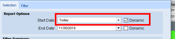

You cannot use HTML in the “Email/Fax” type printout.
If your BAQ’s date criteria is based on “TODAY”, then no you don’t need to have that parameter passed to it from the BAQ Report option field.
Just make sure that you consider the schedules date and time for what “today” will evaluate as.
I have several scheduled BAQ Reports that take in a date as a parameter, and are on a schedule that runs at 12:01 AM. For these I have to set the data parameter as Dynamic, with the dynamic value of “Yesterday”. So when it runs at 12:01 on 11/5, the BAQ uses a date of 11/4.
You could just set you schedule to run at 11:59 PM, but then run the risks of it not actually starting until the next day, or that transactions happened between when it ran (11:59 PM) and the next day.(12:00)

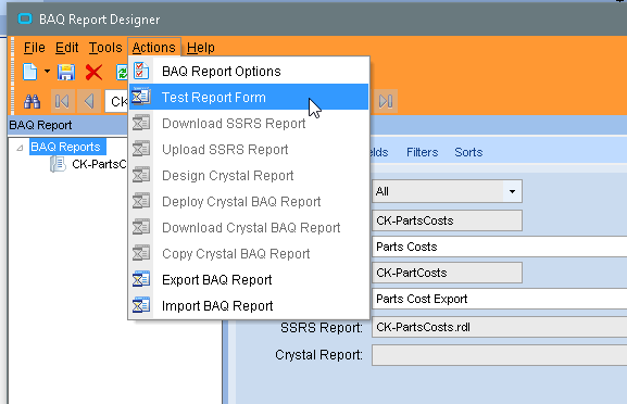

A menu item would be handy for running the BAQ Report whenever you want. But you can actually run and/or schedule it from BAQ Report Designer, via Actions -> Test Report Form

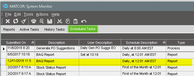

To delete, either
  1. Open the System Monitor and select it on the Schedule Tasks tab, and hit delete (you might have to use the delete icon on the toolbar).
  2. Open System Agent maintenance, find the schedule you selected, and then the task. Select the task and delete it.
Adding the User Description when “printing” saves you from having to guess which task is which. I can’t recall what the highlighted BAQ Report is below (LOL)

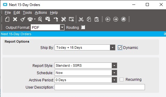

Is there a method that would allow me to select my BAQ report and use the dynamic date option and allow the user to specify a date add expression? For example, I want to report on any orders that have a ship date less than or equal Today + 15 days.Next15-DayOrderReport
If you scheduled that report to run every day at 11:00 PM (and recurring) - with the settings you’ve shown - it would run the BAQ report, every day.
When the scheduled fires today (11/7) at 11:00 PM, the BAQ would be passed the date of 11/22, via your “Ship By” option.
When the scheduled fires tomorrow (11/8) at 11:00 PM, the BAQ would be passed the date of 11/23, via your “Ship By” option.
And so on until you delete the scheduled task.

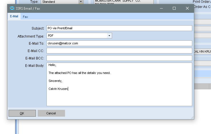

I’m not seeing the same thing. Here’s a screen shot of the Email setup window just prior to hitting OK
And here’s what I received in Outlook
Yes … it is Outlook 2007 (please don’t judge).
