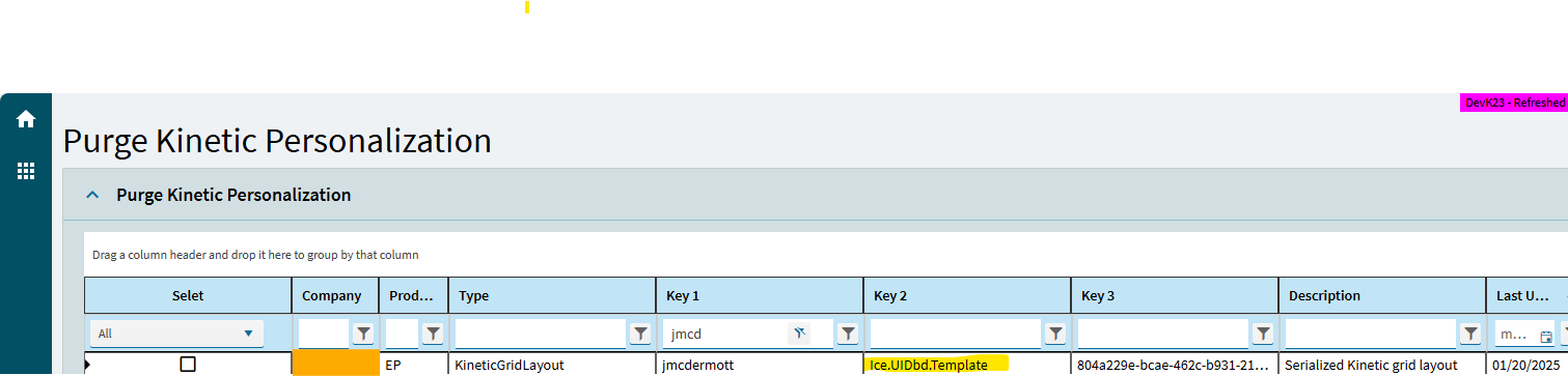

Well, I’m still on 2023.2, (waiting for 2024.2 to mature a little more) and I’m still purging corrupt personalizations by hand.
I tell that story to tell this story:
I assumed that the app name in the URL (highlighted below) was the name of the thing.
So I looked for Ice.UIDbd.SNLotTrack and there were no personalizations against it.
Turns out the personalization was stored against Ice.UIDbd.Template. So I deleted that, and my screen worked again.
Glad there is a last-update column to sort on!
