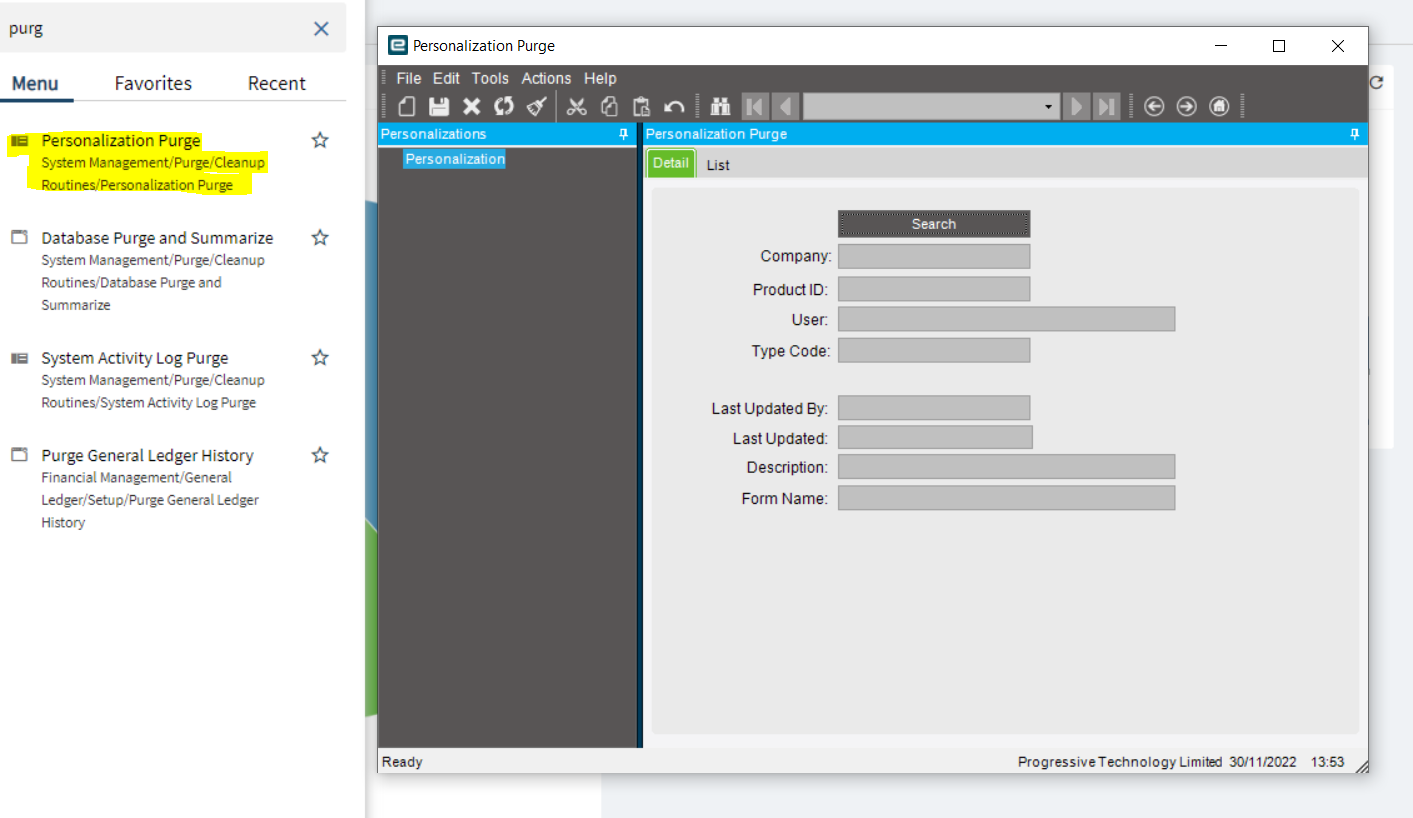

@aosemwengie1 have you tried “Personalization Purge” in full client ?
That only purges classic personalizations, NOT kinetic personalizations, hence the need for the “idea”.

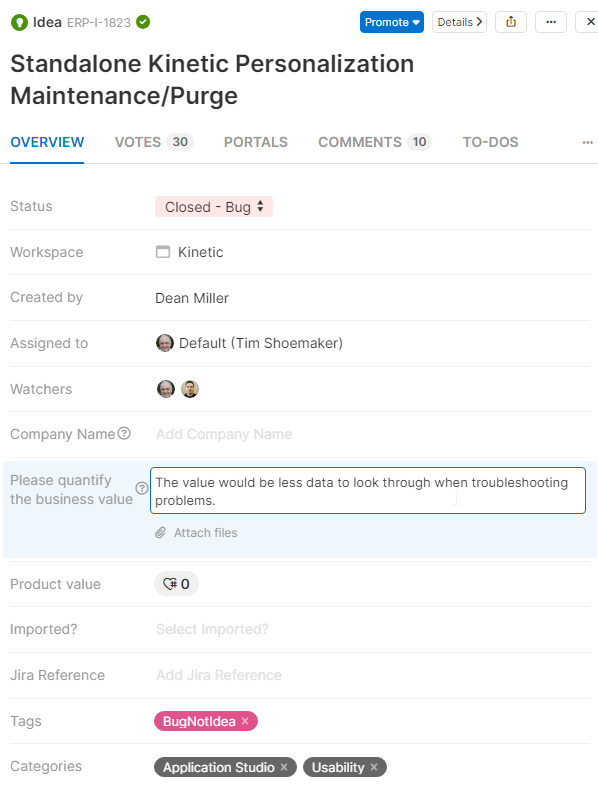

FYI, the idea does have a category, and it does have a status. Here is the “backside” view… this has been closed as a bug because that is what it is… and it should be handled by Tech Support, not as an Enhancement. You should not have to waste your votes on getting a bug fixed. (Note, we have a meeting on Friday to discuss raising your vote count!)

Btw, there is still nothing in the customer-facing view that says this is closed or what the status is . . .
@aosemwengie1 that is interesting… a bug in Aha! actually we have ideas that are marked as a BUG are supposed to be hidden… in fact, if you look you will find that the Status Filter doesn’t show the Closed - Bug status.
BUT if you search for your idea, you can still find it.
I will report this to the powers in charge.

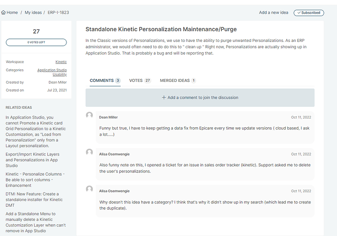

I mean, hiding isn’t a great solution either - anybody who previously saw or voted for the idea might be looking for it and there is no way to know what happened to it? Why not mark as a bug visibly or comment on it so people know epicor is addressing it and don’t create the same idea again? After all, I created the idea originally (the one I created that got merged with this one) specifically at the instruction of support.
