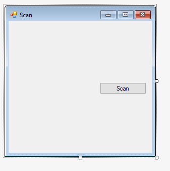

I tried to create sample visual studio web form application to scan orders .
Once the application load time i tried to do develop my code. As per your forum it shows following code help to connect with Ice.Core.Session dll in epicor.

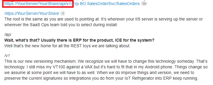

Further i have tried with our Server Root but i have some issue. can we use " /api/v1" by default? i change only the server path but it returns 404.

The ‘Server Root’ is just whatever share you selected in IIS - say MyServer/MyInstance/
For WCF, the services are all under Ice or ERP / BO or lib / Service name. You can get a tour of that by reading the ‘REST Novel’ REST Overview Novel - Experts' Corner - Epicor User Help Forum
If you are having 404 issues, probably easiest to contact support and walk thru the setup with them. Usually it’s a web.config error. They are getting very good at diagnosing those errors of late. People have some interesting IIS server configurations :slight_smile:
