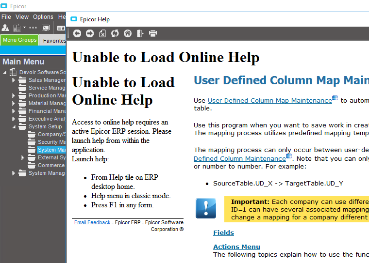

Hello folks,
I have installed epicor help multiple times, even after tried by creating separate instance also my help link is incomplete as shown below.
When i check the same in folder i can find the html files. Kindly suggest how it can be fixed.
Note : I have verified the settings and features as mentioned in this link https://epiusers.help/t/unable-to-load-online-help-error/36058

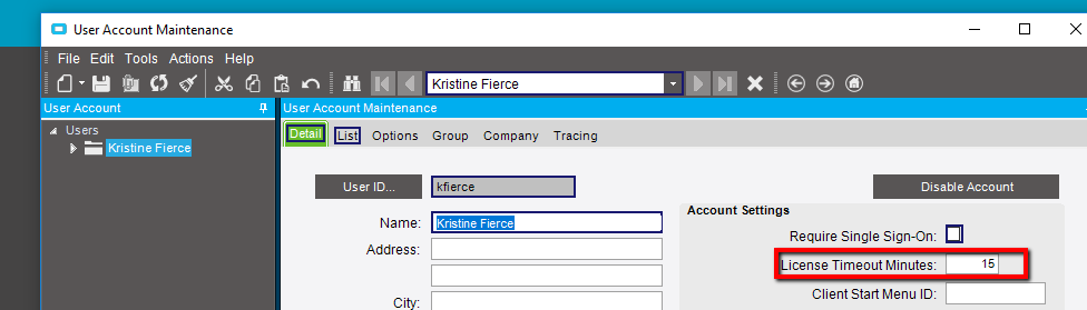

We have a a 15 minute license timeout set on most of our user accounts and if your license is timed out I have noticed Help does not always load.

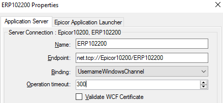

Thanks Kristine,
As the default timeout settings is set to 5 minutes as shown in below. I have changed to 900, still facing the same issue.
I was referring to the User Account Maintenance setup in the application. It looks like you are updating the application pool settings.

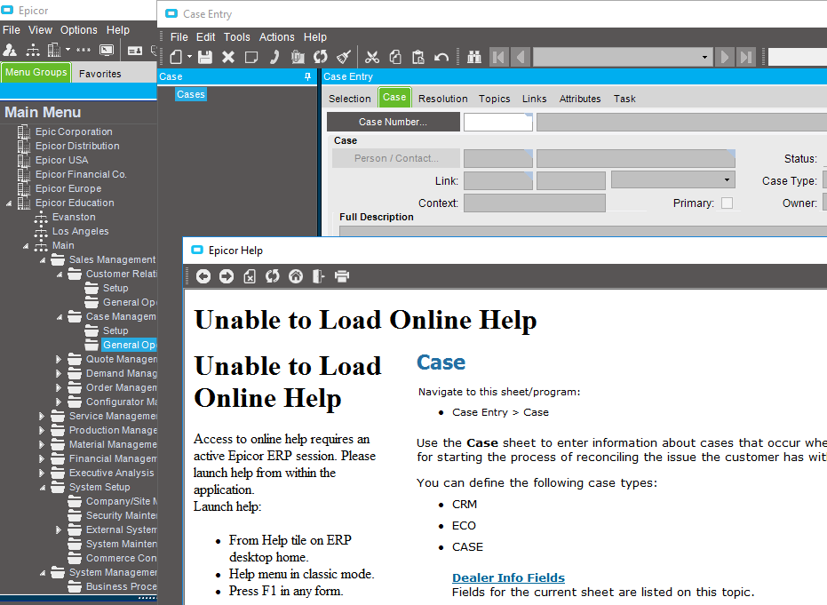

Now I’ve attached the screen shot of my epicor education instance. I’m getting the same error.
Kindly suggest.-Much thanks.

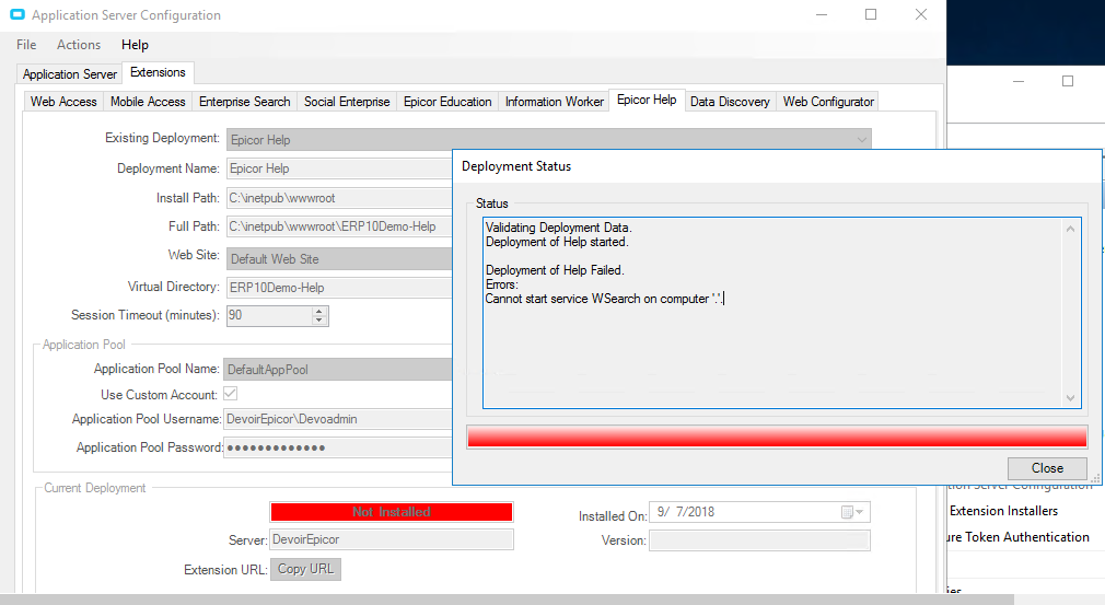

I have deleted the entire virtual machine while tried to install Help i’m getting below error.
Is the Windows Search Service installed an running?

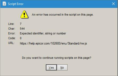

Is anyone’s help broken again? Mine in 10.2.600 is when viewed from Epicor.
ā€œAn error has occurred in the script on this page.ā€ is an indication of being broken?
I see that pretty often.
FWIW - my help (using the epicor URL: https://help.epicor.com/102300) is working.
