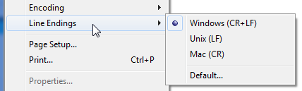

My text editor has the ability to select the line endings and the options are:
Standard Windows is Chr(13) and Chr(10) (CR + LF)
