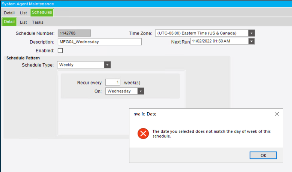

In this case I want a task to run every Wednesday morning at 01:50AM, but no:

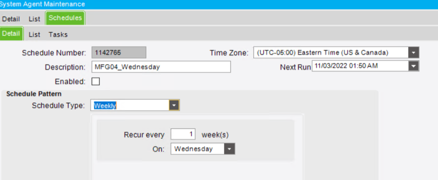

Try setting the time zone, and find a time it will accept, save and click off, and go back and change the time. There are some “issues” with that form.
This is a bug. I reported it already for an issue we were having. I was told by support to remove the timezone and use the UTC equivalent of the time that the job needs to run.

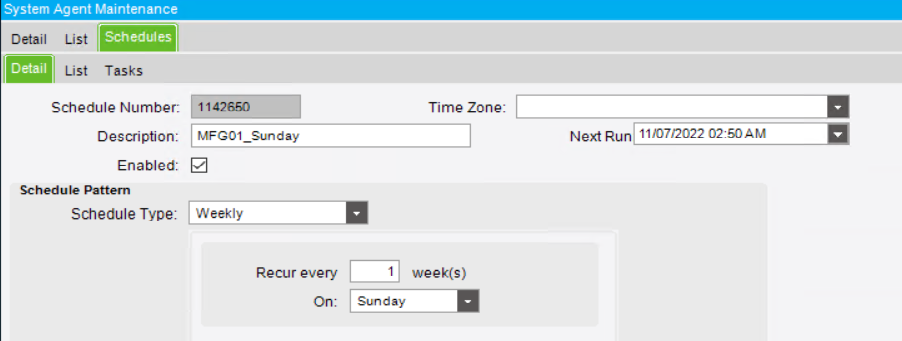

looks like it. I also found a late lamented previous employee created a custom system agent screen that automatically creates schedules/tasks on opening… so deleting existing task is whack-a-mole
AHA, sure enough. When you delete the time zone, the time changes to the UTC version on save - including pushing 9:50PM Sunday to 2:50AM Monday, while leaving the Weekday field intact
