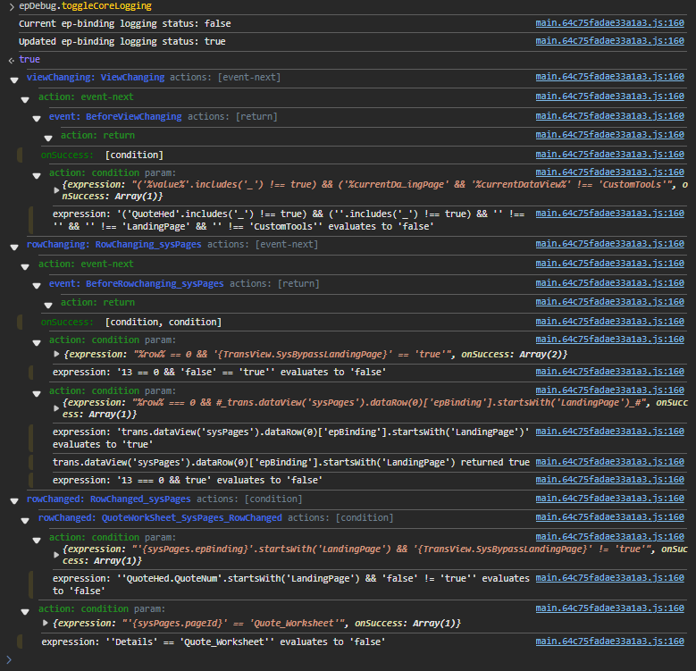

Cool; I didn’t know hardly any of that.
I particularly like the show data views one when trying to dig into something further, because it will show any of the active/used data views in a red font, so you can quickly pinpoint which ones to focus in on.
And this is something that @dcamlin showed me to ensure that events are logged.
> epDebug.toggleCoreLogging
Ohhh - you can type in there too?!
And you can Ctrl+F and search it, too.

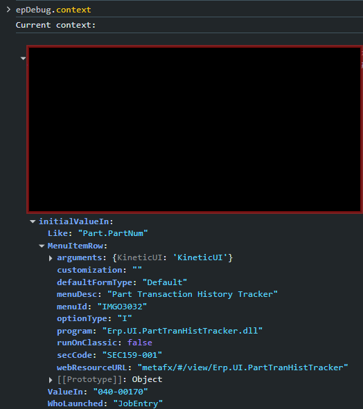

epDebug.context is also useful.
That’s where you can see what values are being passed from one app to another.
… initialValueIn.ValueIn… type stuff.

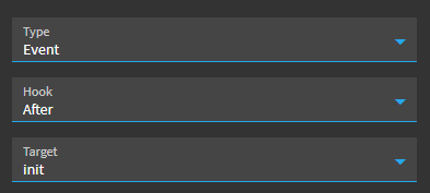

First thing I do on anything i make in app studio is set up the Window.OnLoad event to be a condition checking if the user is me, and turn debug logging on if so, then i put the normal Window.OnLoad stuff I want to do in another event with trigger After Event (the Window OnLoad event).
This helps to capture early events that fire before you get a chance to press ctrl-alt-8 etc.
#_epDebug.setDebugModeStatus(true)_#

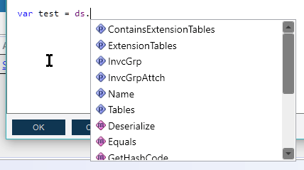

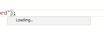

Curious abou the Ctrl+Space thing. Mine always gets stuck with a little box that just says loading. Perhaps I’m doing something wrong there?
Well, it’s pretty much always going to be after a . So, I wouldn’t expect anything to come back after what you are showing there. Also, it looks like that’s in the browser? I’m not sure how good the browser is yet for the autocomplete. I currently am using the smart client, because of those limitations. Unfortunately, Epicor is in a transition period, and some of the new tools still need some work.
