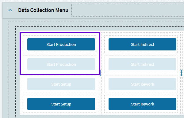

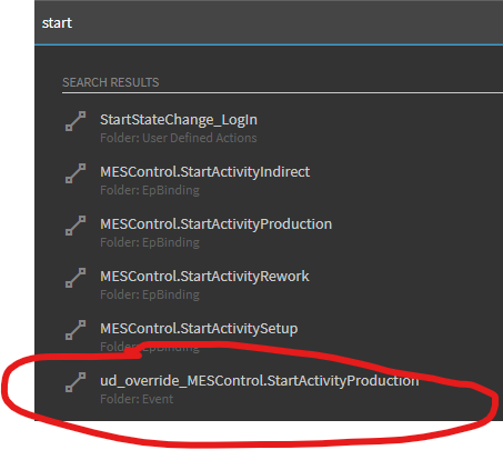

Since you’re reverse engineering… just tossing out another possible scenario (because it is what WE did). We didn’t touch the base controls or events… we just hid the base buttons and created our own button and event.
So, notice, if I unhide in my MES layer, I’ll see the base Start Production button is dimmed. My custom button is the one tied to my custom Start Production event with my layer applied.
Thanks to all. There was a ud override for start production that called the layer.

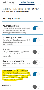

Another tip for these types of scenarios… now with 2025 there is a “Preview Feature” you can turn on to show Application Studio Shell Filters:

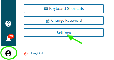

Turn this on by clicking your user in lower left hand corner and then go into settings:
Then, under Preview Features, turn that option on:
Then, in application studio, when you search in events, you should be able to apply the User Defined filter… this is a huge help in finding YOUR events vs. system events.

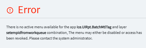

I have been able to resolve most of these instances in our system, but one is still giving us issues.

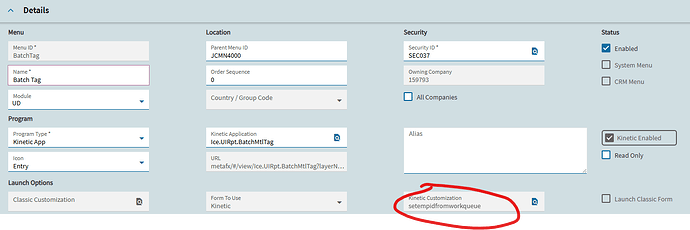

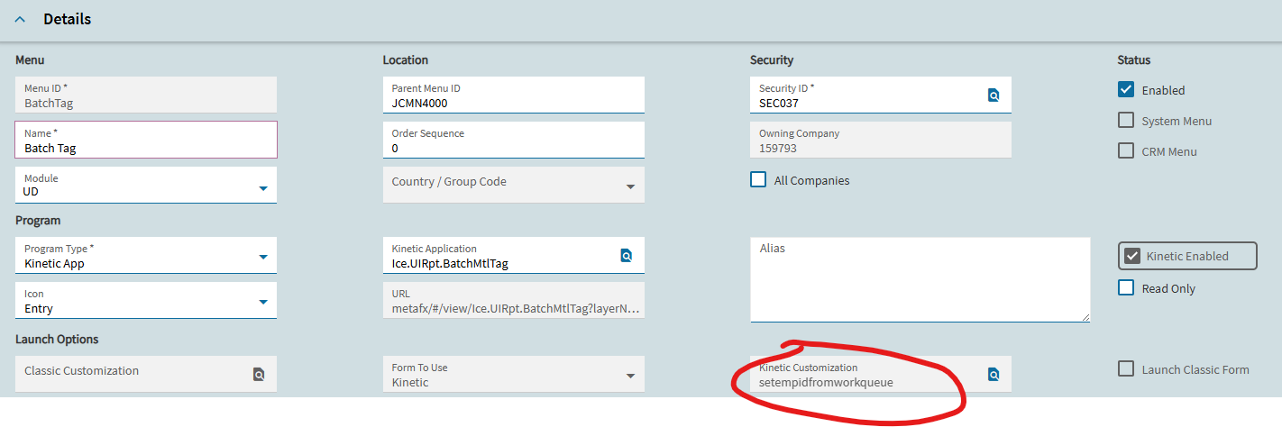

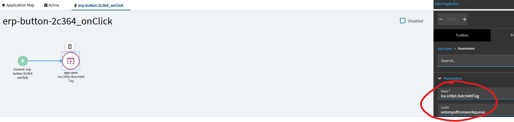

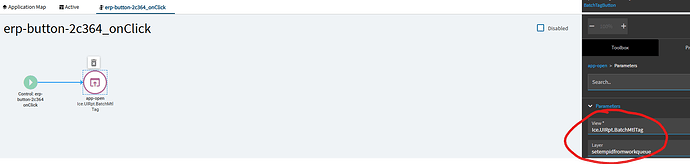

I have a custom button in Work Queue which mass prints tags for selected jobs in the queue.
I have the layer defined in the OnClick
And the customization is selected in the menu
But we continue to get this error.
This is the response I got from Epicor Support:
Your understanding and analysis of the issue are correct. This behavior is occurring due to a recent security enhancement. The recommended solution is to customize the PO Entry UI so that it opens the MENUID associated with the layer, rather than using the Kinetic app name.

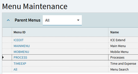

What I usually do in 2025.2.x to get an app/layer combination accessible without being on the menu is to stick it under PROCESS:
As long as it’s in here, with a Security ID accessible to the user, the slideout should function. It should not pop up in the menu search.
I’ve had to do this for the same reason, I have customized menu items in Epicor that I’ve purposefully removed the base for, but there are some scenarios like a slideout call from another app that need the base.
This is what I had to do in 2025.1.13 to hide a BAQ Report but have it available as a slide out.
This is the solution I went for thank you, Job Manager now works and the cloned menu doesn’t show in search, thanks all for the replies much appreciated
