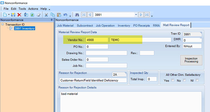

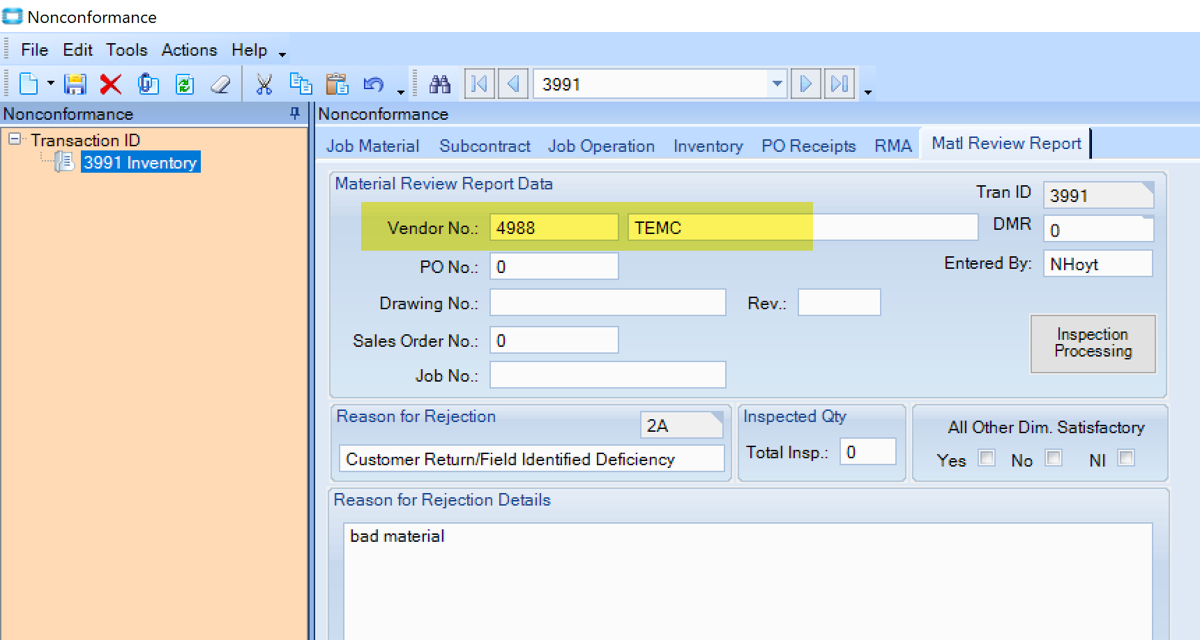

We have the same need and we used a UD, NonConf.ShortChar02 to hold the vendor ID data. See our customization below.
I just reviewed what we did in regards to passing the VendorID into the DMR as needed. I guess I never got to that part :frowning: QA manually re-enters the Vendor ID if it is an inventory DMR.
Nancy

Are you doing a nonconformance from Inventory? That’s what we have here above. System doesn’t know which PO/vendor since the part is in inventory so I guess that’s why we need to tell it here. I think nonconformance field for vendor num is there for PO inspection processing where it knows the vendor id. It is too bad that we cannot just use the existing field for the Vendornum for the inventory NCR however. That’s why we took the matter into our own hands :joy:
Nancy
