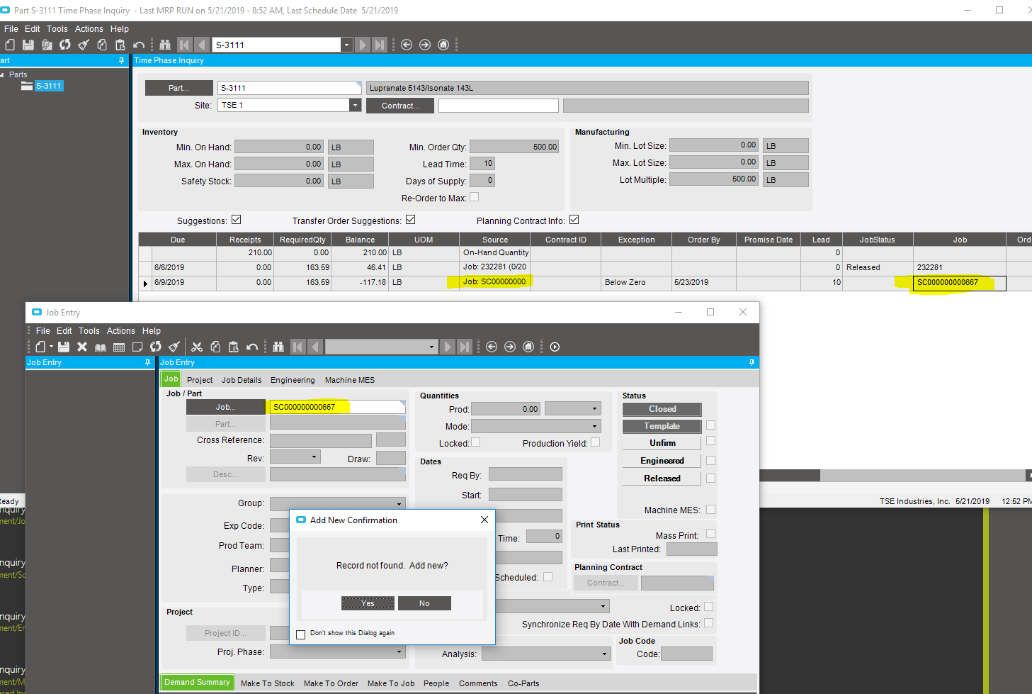

Non Existent Unfirm Job in Time Phase
See my screenshot.
That does not make any sense. What is causing this and how to i fix it.
Weird. Just to make sure, do you have the same result using right-click and Open With Job Tracker from the job number column in Time Phase.
On Tracker nothing pops up.
SC the prefix for MRP jobs?

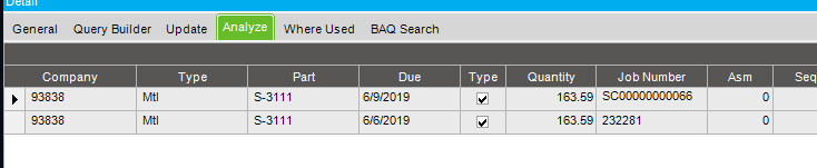

Query the PartDtl table for that job. It has all the supply and demand records. We had a rogue entry in that table one time and it showed in Time Phase.
yes
Just like Scott suggested, query the PartDtl table and filter it on partNum = ‘S-3111’.
Do you have multiple plants setup? Open with job tracker from wrong plant in certain ways can make it seem like record doesn’t exist.
Nancy
It would say that the job is related to a different plant instead of no records found.
