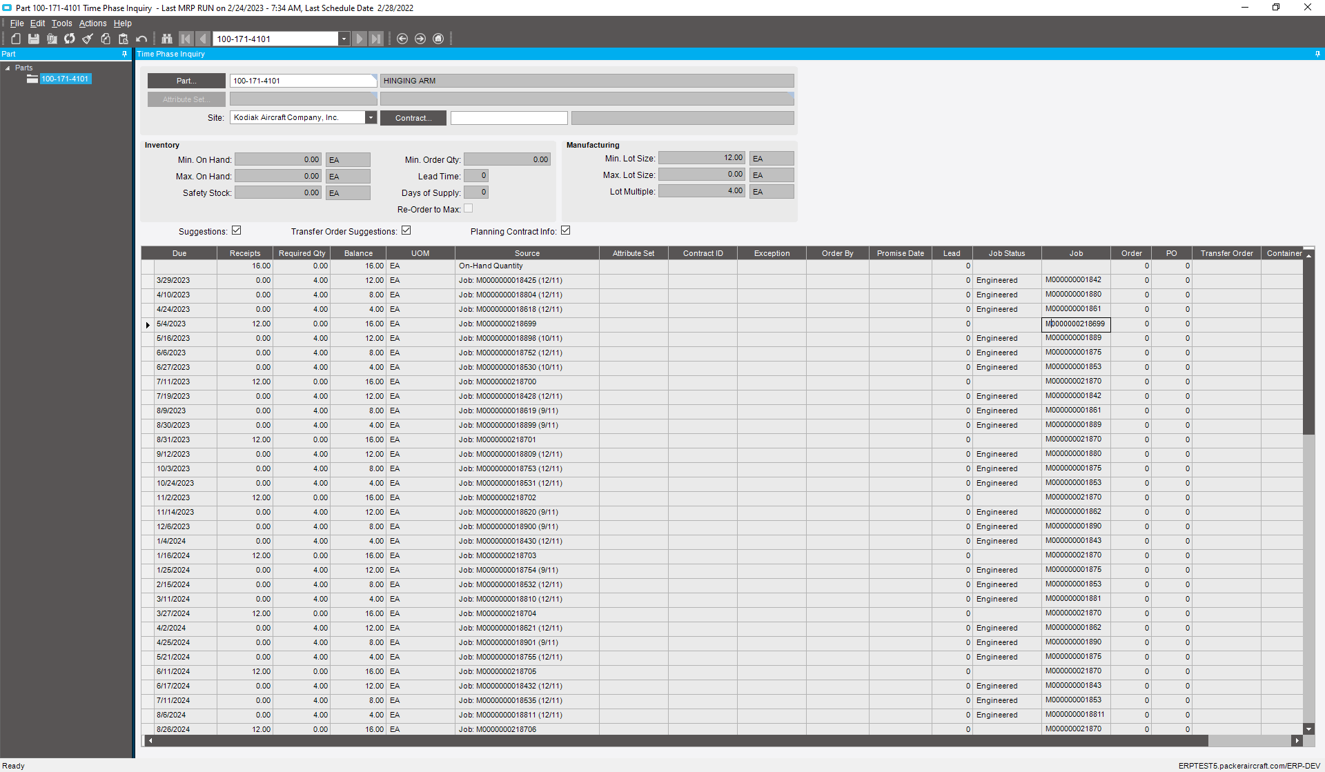

In Time Phase it’s showing Receipt Quantities but when you go to Job Entry the job is not there. How do you all fix this?
How often do you run a regenerative MRP?
Every night cuz our demands change so quickly and the parts that have this issue keep showing up
Okay, do you have any BPMs on job creation? When I was locking down the JobNum (people love to turn that into a secret code fest) I managed to prevent MRP from generating unfirm jobs. I don’t think I had erroneous records in PartDtl (where Time Phase draws from) but still…
If that isn’t it, I’d file an EpicCare ticket. You’ve got a mismatch between PartDtl and your other tables. They have better tools to fix that than I do.
