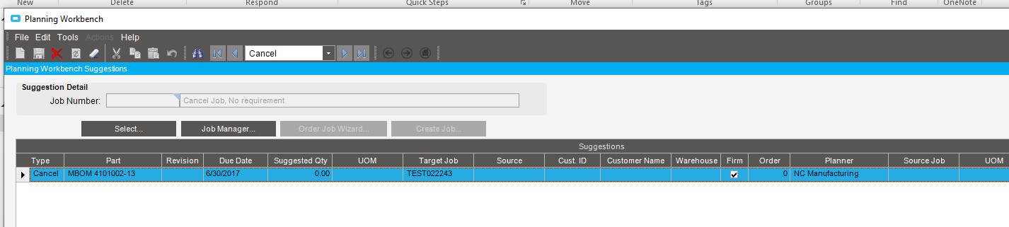

I have a job that keeps popping up on the Planning workbench to cancel. But the job doesn’t exist in some tables I have checked and the Part Num doesn’t exist. I am guessing someone deleted something and now it is hanging in limbo.
Any suggestions to find this job or cancel it?
thanks
If you right click on the job number and “Open With” does it bring up anything in job entry or tracker?
Nope no job opens and then I search for the job and nothing pops up. I even did a search in the SQL on the JobHead table and nothing.
I believe it’s in the PartSug table. Have you run MRP again to see if it disappears? Or do you delete the suggestion and it keeps popping up?
