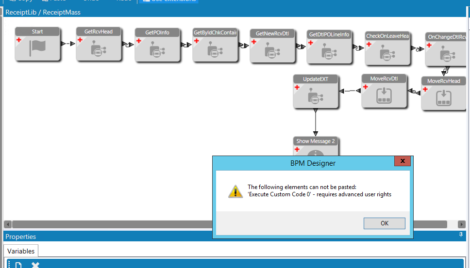

Is it possible to turn a existing function into one with code without recreating it? I tried to paste the execute custom code into my existing function without code and got this
I think you are going the opposite way that you need to.
  1. Open non-code function; copy all widgets
  2. Open code function and paste widgets
  3. Add custom code block, connect it in, etc.
And of course there is a step zero before all that - create the code function (the header/signature) with all of the inputs and outputs
Or, you know, use the @ckrusen method of automatically binding 283 fields… No code required.
Yeah I tried that and got a ton of compile errors
Blake,

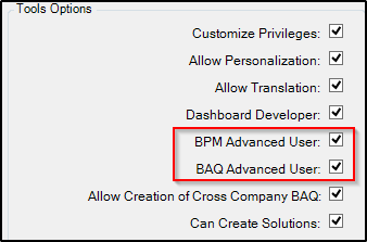

Looks like that error message might be related to your user account. Do you have “BPM Advanced User” permissions on your user account?

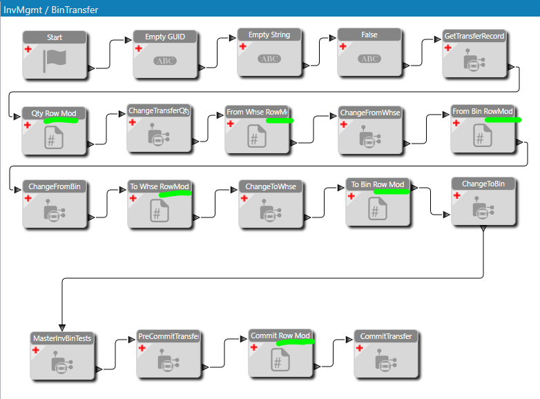

No, I had to keep those rowmods in there. Haso was explaining why in another post and that’s one reason why he doesn’t use the widget approach.
-Utah
Indeed. He even borrowed your picture.
Yeah, you’re baiting me into rehashing that and I am doing all I can to resist, but anyway… That is insane. OK, confirmation is what I wanted and I got it. Thank you.
