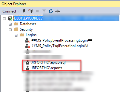

As an example, I have my EpicorSQL account running all things SQL related
SQL Services running under this account for this SQL Server:
