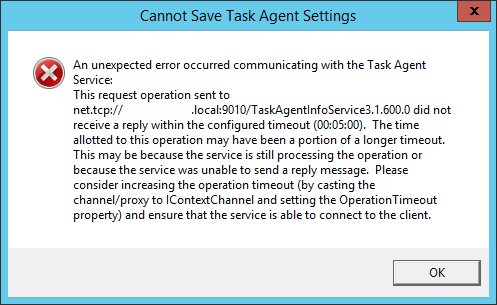

Yesterday our Task Agents became a little wonky, so I tried restarting them to no avail. So I did a quick reboot of the server and everything seemed fine. But when I get to the office this morning, it seems that the issues are popping up again. I receive this error when trying to start or stop any of the task agents.
Anyone run into this type of issue before?
