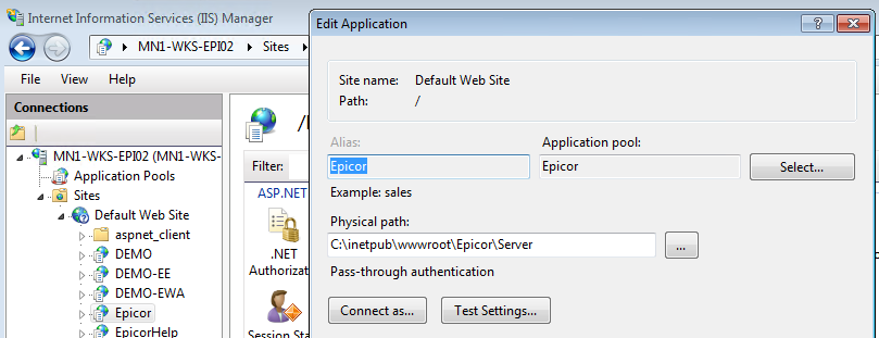

If you open IIS manager and look at your sites, you can see the path using basic settings. That path would replace the generic instruction path.

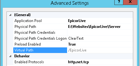

Thanks for the tip. Does this look like the correct path I need. I don’t think I went to the same place you did in IIS.
Yes, the E:\Websites\EpicorLive\Server would have your web.config file.
Thanks!!!
