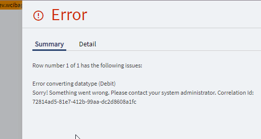

Hello,
I am entering a journal entry, using “paste update” from an excel file. The entry pops a soft stop error that appears to be related the number of digits in the debit or credit field. If the number is in the millions (1,000,000.00), it won’t paste/update. I can hit the button to “Continue” and it skips that row completely. I then have to enter that row manually (no stop on the manual entry of the number).

Nope, that didn’t work either. I got the same error message

It looks like you are using the classic version, I’m on Kinetic and using the browser.
I wonder if this is an issue with Kinetic?

So yep, it’s the commas.

I say bug, since it works in classic.

Are we back to thinking it’s a bug with Kinetic?
with a workaround, format the column like @jgiese.wci did
