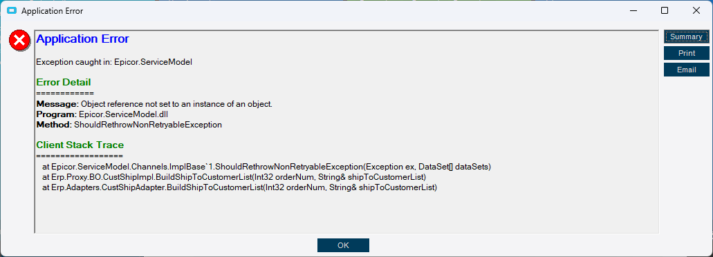

We are having issues when creating a new Pack ID for a specific order. We open the Customer Shipment Entry screen, click on New Pack ID, and then type in the SO# and hit Tab, and then the background methods start to process before throwing this error:
Error Message Text
Application Error
Error Detail
Message: Object reference not set to an instance of an object.
Program: Epicor.ServiceModel.dll
Method: ShouldRethrowNonRetryableExceptionClient Stack Trace
at Epicor.ServiceModel.Channels.ImplBase`1.ShouldRethrowNonRetryableException(Exception ex, DataSet dataSets)
at Erp.Proxy.BO.CustShipImpl.BuildShipToCustomerList(Int32 orderNum, String& shipToCustomerList)
at Erp.Adapters.CustShipAdapter.BuildShipToCustomerList(Int32 orderNum, String& shipToCustomerList)

At this time, I click “OK” to dismiss the error and it pops up a 2nd time. Nothing on the Shipment Entry screen changes after the 1st error is dismissed and the 2nd appears.
