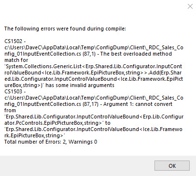

which passes the syntax Check perfectly but when I add the code to add a list entry for any Input picturebox (example one called called Inputs.imgVar_000) I generate a syntax error shown in the picture attachment:
Image_Var.Add(Inputs.imgVar_000);
Looking through the Infragistics manual they mention an UltraPictureBox as well as EpiPcPictureBox. I have also tried to define this as the base class but that generates a Syntax error straight away.
