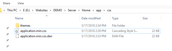

If you decide to try this please make copies of these files.
1 - Edit the application.min.css file in this folder
2 - Edit this portion of the css, changing just #FFF to another color, and save.

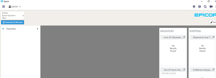

.ehp-tile-group-container {
  background-color: DarkGrey;
Gives you this.
