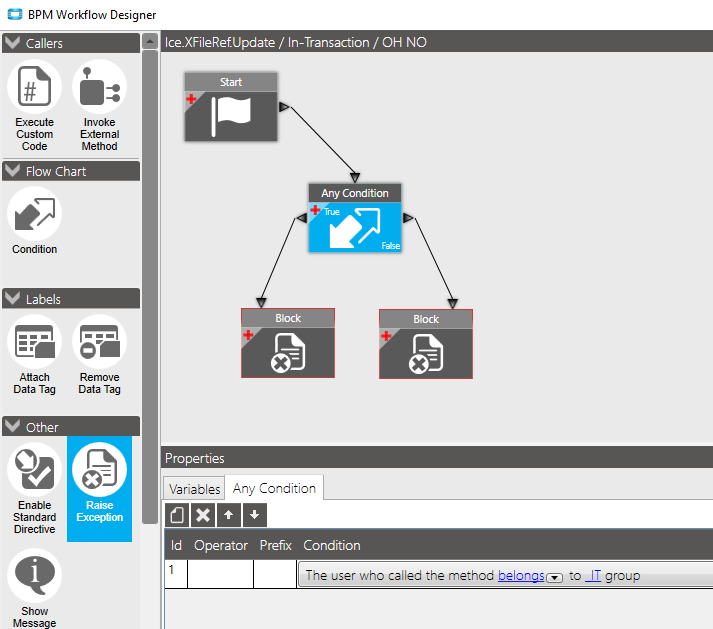

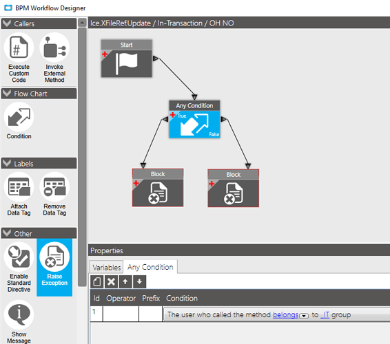

Could we add a Data Directive to block adds to XFIleRef until you get the AppServer restarted?
What should the data directive look like?
Nice
This worked!! I put in an in-transaction data directive to raise an exception on both tables XFileRef and XFileAttch. After I saved it, the records have finally stopped increasing! Now I can run my delete BPM to clear out those tables and try again!
Thank you so much for the little workaround @Mark_Wonsil!
But as soon as I disabled those data directives, the records started being added again.
I think you’ll have to keep it disabled until the Epicor Cloud Team restarts your appServer.
