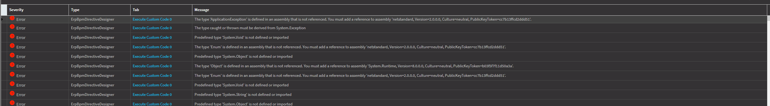

These are the errors we are getting.
Looks like the same as this, just for .NET 8

this is the sever side exception through the classic Method directive screen.
There is at least one compilation error.
CustomizationFactory.cs(2,14): error CS0234: The type or namespace name ‘Collections’ does not exist in the namespace ‘System’ (are you missing an assembly reference?)
GetNewABCCode.CommonTypes.cs(3,14): error CS0234: The type or namespace name ‘Collections’ does not exist in the namespace ‘System’ (are you missing an assembly reference?)
GetNewABCCode.Post.AutoCheck.Designer.cs(15,14): error CS0234: The type or namespace name ‘Collections’ does not exist in the namespace ‘System’ (are you missing an assembly reference?)
GetNewABCCode.Post.AutoCheck.cs(15,14): error CS0234: The type or namespace name ‘Collections’ does not exist in the namespace ‘System’ (are you missing an assembly reference?)
GetNewABCCode.CommonTypes.cs(13,46): error CS0012: The type ‘Object’ is defined in an assembly that is not referenced. You must add a reference to assembly ‘System.Runtime, Version=8.0.0.0, Culture=neutral, PublicKeyToken=b03f5f7f11d50a3a’.
GetNewABCCode.CommonTypes.cs(45,66): error CS0012: The type ‘Object’ is defined in an assembly that is not referenced. You must add a reference to assembly ‘System.Runtime, Version=8.0.0.0, Culture=neutral, PublicKeyToken=b03f5f7f11d50a3a’.
GetNewABCCode.CommonTypes.cs(30,55): error CS0012: The type ‘Object’ is defined in an assembly that is not referenced. You must add a reference to assembly ‘System.Runtime, Version=8.0.0.0, Culture=neutral, PublicKeyToken=b03f5f7f11d50a3a’.
CustomizationAdapter.cs(9,53): error CS0012: The type ‘Object’ is defined in an assembly that is not referenced. You must add a reference to assembly ‘System.Runtime, Version=8.0.0.0, Culture=neutral, PublicKeyToken=b03f5f7f11d50a3a’.
GetNewABCCode.CommonTypes.cs(17,16): error CS0012: The type ‘Object’ is defined in an assembly that is not referenced. You must add a reference to assembly ‘System.Runtime, Version=8.0.0.0, Culture=neutral, PublicKeyToken=b03f5f7f11d50a3a’.
GetNewABCCode.CommonTypes.cs(17,16): error CS0518: Predefined type ‘System.Object’ is not defined or imported
GetNewABCCode.CommonTypes.cs(21,9): error CS0518: Predefined type ‘System.Void’ is not defined or imported
So, check your server, for some reason it does not see .NET 8 SDK installed there.
