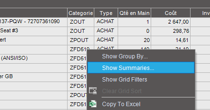

Option #1 : Activate Grid Summaries
In the dashboard, any user can interact with the grid to display summaries.
  1. Right click anywhere in the grid and click on “Show Summaries”

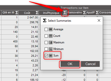

  2. Now, summaries icons appears on the header of columns. Click on it, check “Sum” and click “OK”
  3. The summary appears at the bottom of the grid

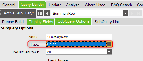

Option #2 : Summary row in BAQ
In your BAQ, you can use an union subquery to get the same result as your SQL statement
This is explained in the Ice Tools User Guide
