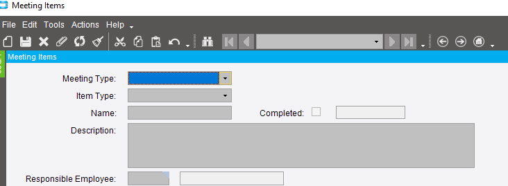

The issue comes in that when I pass the word NEW I want it to create a new record and load that record to edit. It successfully creates the record every time. It does not then load the record to edit it. I set the keys upon creation of this new record (it’s a BPM on the UD26.GetaNewUD26 BO) . The problem is that when I run this.oTrans.GetByID(Key1, Key2, Key3, Key4, Key5); after creating the record it does not load it. It will however load it if I click a button afterwards. The button click event is a duplicate of the last two lines that are running on the form load with no changes so why is the click needed and how can I remove the need for that button?
After adding a couple more message boxes, it does load the record correctly after creating it, but it then immediately clears it. If I put a message box at the end of the form load event, the record is on the form until I click OK and then it immediately clears. Anyone have any idea why it does this and only on the newly created record and not on previously created ones?

Those values are set on the GetANewUD26 BO via BPM. The keys are set and work because I can pull up the record via those, it just requires a button click. I found a terrible workaround in which on the form_shown event I am popping up a MessageBox that displays a message and when the user click ok, then it loads the record. If I remove the Message Box it loads and then clears immediately. The problem is that if I don’t have the user interaction it loads and then clears faster than it can be seen.
Seems like we’re fighting the EpiMagic here at load time… :thinking:
I believe that’s exactly what I’m fighting. Just not sure why it’s different than just coming in and pulling up a record (that works great). If I use a button to load the newly created record, works fine. If I add a message box, it works fine as well.
	private void UD26Form_Shown(object sender, EventArgs args)
		if (UD26Form.LaunchFormOptions != null && UD26Form.LaunchFormOptions.Sender != null && UD26Form.LaunchFormOptions.ValueIn != null)
				if (key == "NEW")
					MessageBox.Show("Check that meeting type and item type are correct");
					this.oTrans.GetByID(Key1, "Item", "", "", "");
					this.oTrans.NotifyAll();
This code “works” but if I remove the MessageBox, it does not. It technically loads the record then immediately clears it. Had the same issues trying it on EpiViewNotifications as well. I also tried using Sleep but it just clears as well. The only way that seems to work is forcing user interaction. I hate using workarounds but not really seeing any other way to get this to work.
