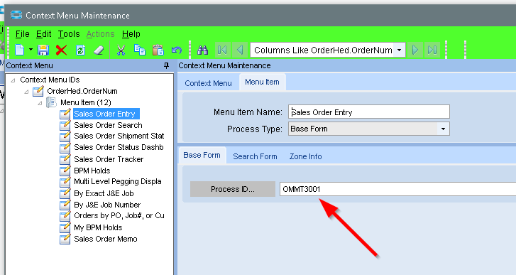

We added some customization to a few entry screens, e.g. Order Entry, and we want users to use the customize version, so we removed the default Order Entry screen from the menu. Now our users are getting an error if they are on another screen, e.g. Customer Entry, and from the Customer ID field they right-click and select ‘Open with - Order Entry’.
Where can I change the options for ‘Open With’?
Context menu maintenance
Found in: System Setup -> System Maintenance
In the pict below, change the Process ID (the menu ID in menu maint.) to a menu ID that specifies the customization you want.

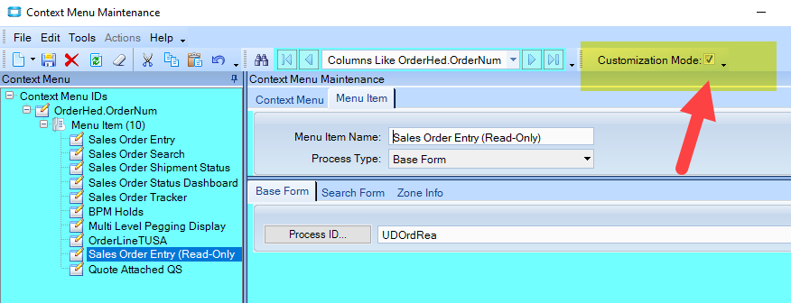

PS: don’t forget customization mode checkbox, as needed!
