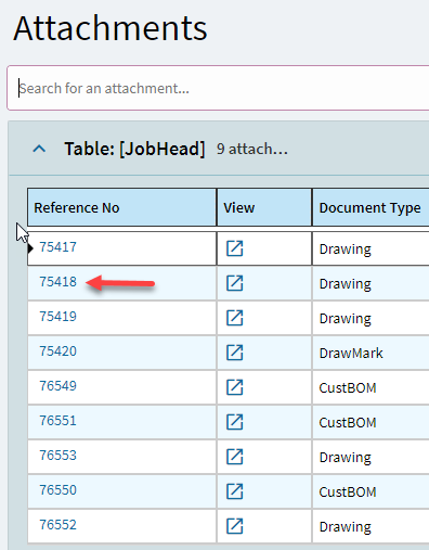

this is more question for Brian, I donât know, if this was discussedâŚ
But I see there is a View colum with links on this UI. What happens when there are clicked?
@Olga that will open up the file directly IF it is a local file. For ECM users, that button opens the file in ECM and consumes a license.
Attachment usage within ERP / Kinetic has a number of different rules and settings and the Browser code is maturing to provide as close to the same behavior as the Smart Client. As a result, there are ongoing adjustments to this behavior.
One thing to look for on your ECM Attachment configuration in Kinetic - are you setup for Server file transfer or Client file transfer. If set for Server, all access to ECM is supposed to go through the Kinetic AppServer so the only license consumed is the AppServer communicating with ECM.
There was a misunderstanding of this functionality and the Kinetic UI team thought ECM view/download was always handled by going direct to the URL - I believe this is / has been addressed.
@klincecum - we treat attachments as Secured documents so direct http/https access is typically not something that would work - but we do allow Client Side direct access depending on how the Attachment type has been configured. For ECM / SharePoint, (Dropbox and G-Drive ??), the Client Side configuration presents a challenge and requires logon. Regardless, attachment access is something we are refining / improving.

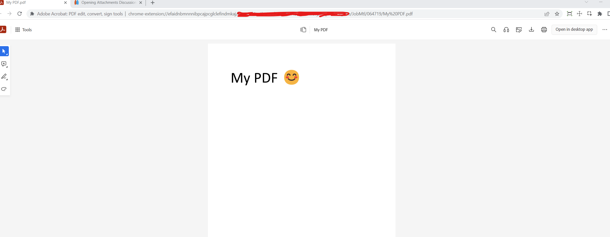

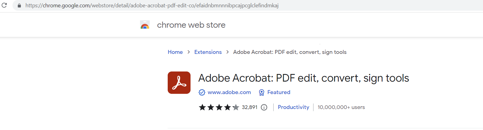

Just spit balling an idea of the back off the back of @klincecum default program opening suggestion.
If you are working in Chrome, you could utilise chrome extensions and develop a function to create a URL and âRedirectâ as such.
- Add chrome-extension://efaidnbmnnnibpcajpcglclefindmkaj/
2 .Then in your function build a URL (you can use Path.GetExtension from you file path to trigger it down different routes)
e.g:
PDF:
chrome-extension://efaidnbmnnnibpcajpcglclefindmkaj/YourFilePath
Excel:
chrome-extension://gbkeegbaiigmenfmjfclcdgdpimamgkj/YourFilePath
Output example PDF:
