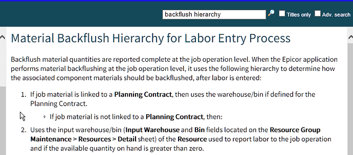

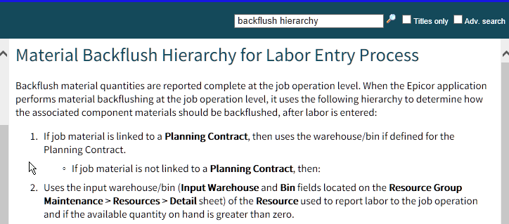

There’s a help doc that explains the hierarchy of where things will get backflushed from. I believe it’s accurate, but I would definitely test it, as I’ve seen issues with it in the past (Might be interpretation or bugs, I don’t remember)
One of the things you can set is a in/out bin based on resource group. So this would relate to your operations that you have set up. So it sort of follows the MOM.
Take a look at that anyways.
Regarding the hierarchy, in 10.2.400, #2 and #3 indicate it will not backflush from those locations if inadequate quantity exists. This is not true, it will take you negative.
backflush location can be defined based on the OPERATION’s chosen resource or resource group.
