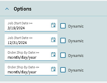

I was asked to have the option to filter a BAQ report by either a Job Start Date range OR an Order Ship By date range. I’m going at this BAQ report from a BAQ-based RDD.
My BAQ parameters have “skip if empty” selected and are working as desired when just testing the BAQ. However, the Kinetic print screen for the BAQ report auto-populates a date into each of the option fields. If I delete one set of them (see image below), I get an error that I’m trying to feed a string into a date field. I don’t see an option to leave these fields “blank.”
Any thoughts? Are optional parameters/BAQ report options possible?
