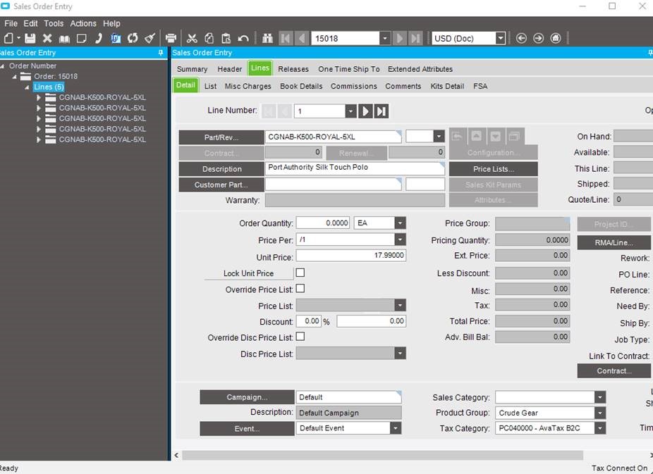

Hello all, some of our order entry team have been having this error pop up when entering lines. Entering part, then quantity, they have this error pop up.
They say that pressing OK causes the lines to duplicate when they come back to the order.
They say that they have not noticed any particular pattern for what causes this error, and in my own attempts to track it down I have not noticed a pattern either. I haven’t been able to find any other discussion of this error on this forum. Does anyone have any experience with it and/or know what is causing it or how to prevent it?
