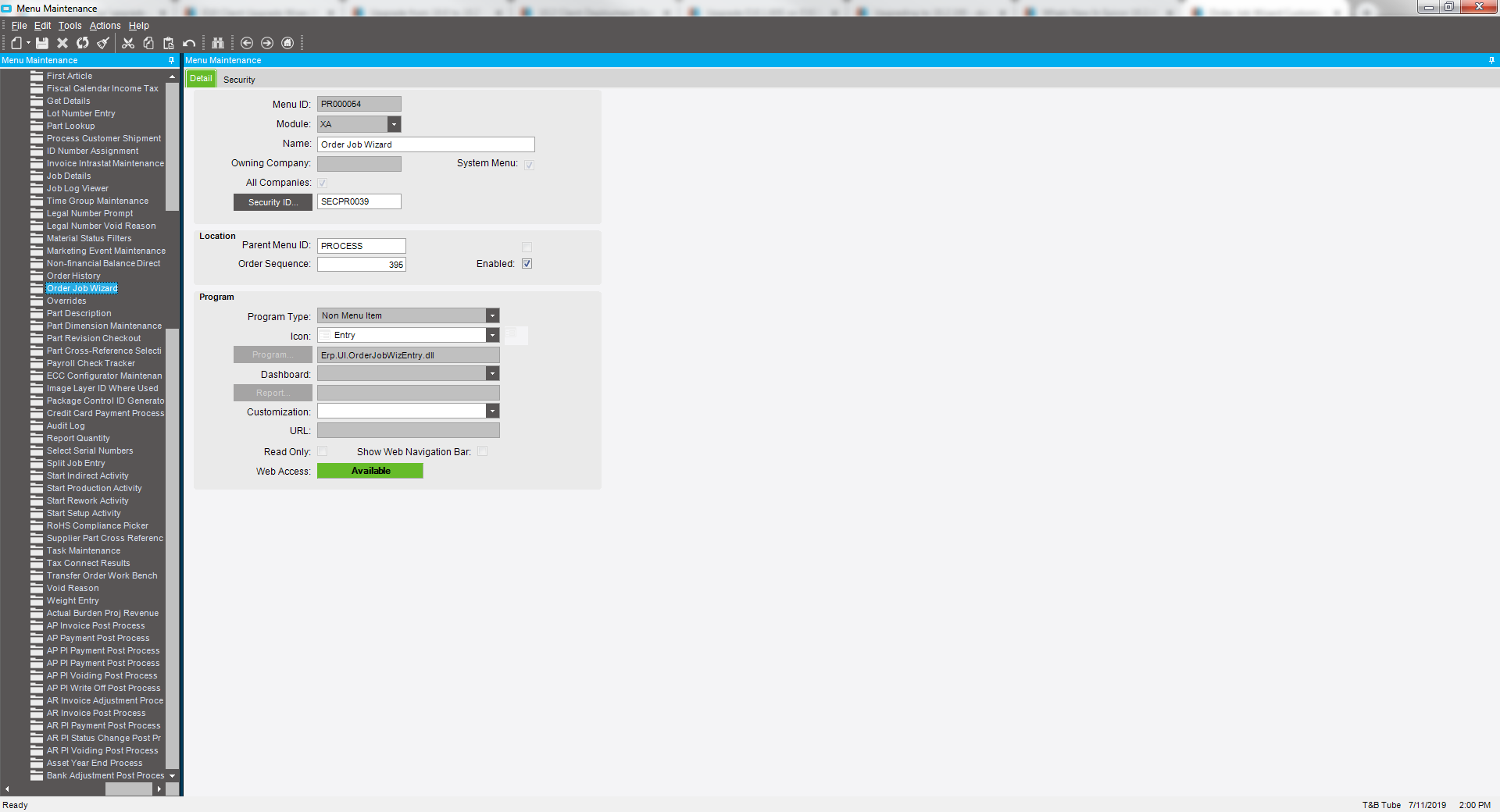

I have a Customization for Order job wizard. It is named the same as the customization as the order entry form customization. When I run it the customization for order entry works(was existing) but the one for the order job wizard is still the base form. Is there something I am missing or is there a new way to do this.
Under Processes in Menu Maintenance for OrderJobWizard tie it to the customization also.
There is no order job wizard under processes. I checked that earlier. unless its hidden somewhere else.
This worked. Thank you. I didn’t realize that creating a new process would link the two. Thanks
