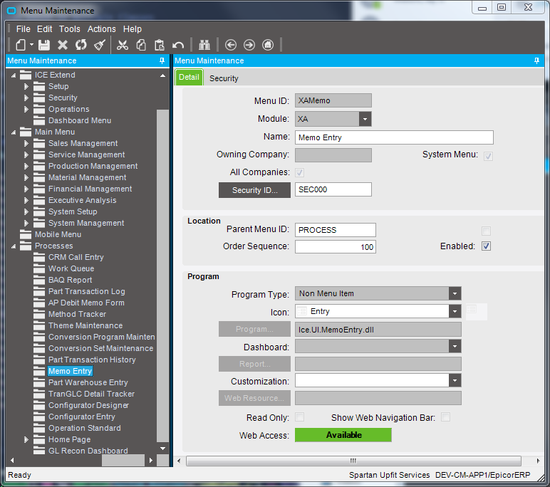

If I recall you then go to Menu Maintenance add that child form under the Process node
Set the Customization Here etc…

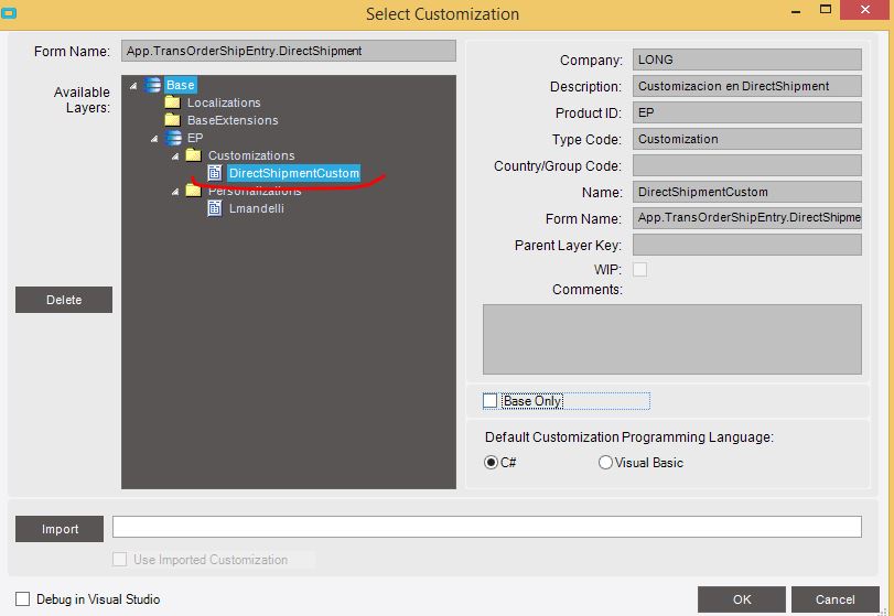

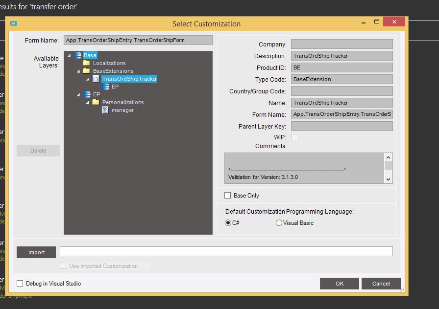

i have a custom on Transfer Order Shipment Entry, there is where ask me for load that, if u see the “Direct Shipment” customization is not loaded here.
So i load ir or not… i go to “Direct Shipment” on action menu.
After that dont show me any information such a process, directly show me the “select custom dialog” and only the directshipment customization appears.

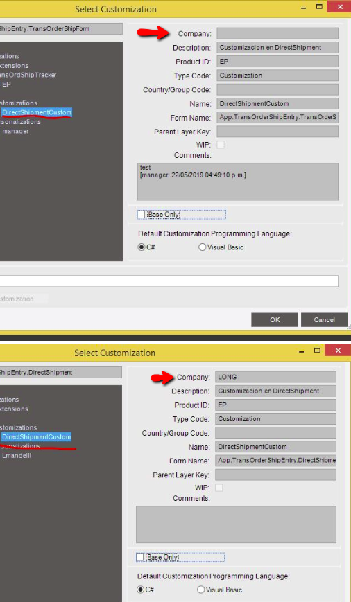

i try the solution u give me, dont work:
same name in customizations
menu configures with that custom
the result i want:
when create new line and select partnum on Direct Shipment, put on Warehouse and Bin the PrimWhse and PrimBin that i have in Part (DirectShipmentCustom(child)) do that.
(if we see the FAQ for the field it should work with no custom… but dont do it… set another warehouse and bin)
nothing happen… and if i load the custom manually it work.

The only thing I can think of is that the Company must be the same on both Customization Layers, either same Company or both All Company
@Jason_Woods / @josecgomez was it the Customization Layer that had to match between a Parent Form and Child Form when it didnt have a Process or does the Customization Layer have to be the same name as the Parent Program Form Name?
@DanB I think you have to mark both Customizations as All Companies then restart Epicor Client. I just tested it on mine and it works.
Pay Attention to Titlebar
ohhh thanks so much! and more for be patient cause of my! now its working!, one more question, how u make the gif “video”? i very usefull!
