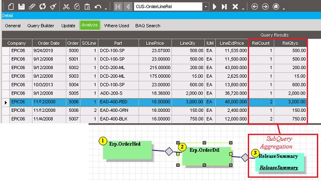

Sounds like your dashboard includes detail columns from both OrderDtl and OrderRel tables?
If so then yes, you’re mixing “dimensions” but the issues only reveal themselves when you have more than one release for the line(s).
Without more detail, I’m just guessing you need to add some aggregation somewhere.
Here is a screen shot of an example BAQ, where the OrderRel values are summarized in a subquery.
