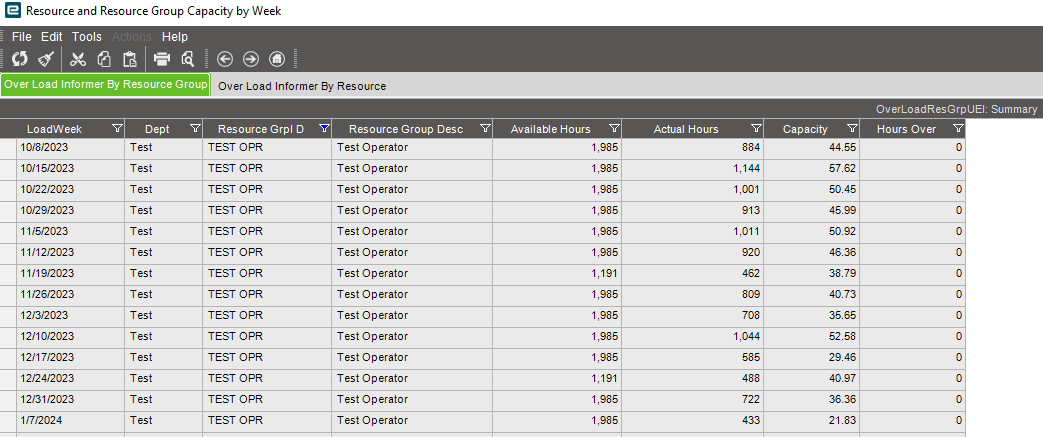

An unfortunate out of box limitation is that daily analysis isn’t very useful. I recommend recreating this report and looking at weekly buckets instead. When setting it up this way make a version by resource and another version by resource group. Capacity is found in table ShopCap. Overload is found in table ShopLoad.
In short, analyze machines by resource and employees by resource group for better results in the overload infomer.
Forgot to mention, if you want to see the breakdown on a certain date with a certain resource use the Resource Scheduling Board and it will show you every job that is to be running that day in that resource.
