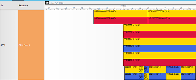

We are currently working in test environment and having trouble with finite resources. Despite the resource being finite and clicking finite when we run global scheduling, the resource becomes overloaded (see screenshot).
The resource in the attached screenshot has an 16 hour a day calendar and is marked finite, and the resource, group and site all have a finite horizon that goes long past the date in question. We showed our consultant and she went over our settings with us and attempted to re-schedule, but couldn’t figure out the issue either.

By Default the Late Color and OverLoad Color are VERY close. Can you change one of them to another color to confirm those jobs are actually late. I think they are but it is hard to tell in the screenshot.
Also, review the Overload Informer as you should see more information on the capacity.
