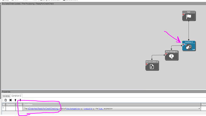

It is not as straightforward as it sounds but to explain it in a very simple format, when the checkbox is checked, a series of evaluations (If statements if you will) will examine the Order characteristics and if a certain criteria is met in each conditional statement, we would like to perform certain operations, one of which is overriding the credit-hold.

This is the complete code that I have:

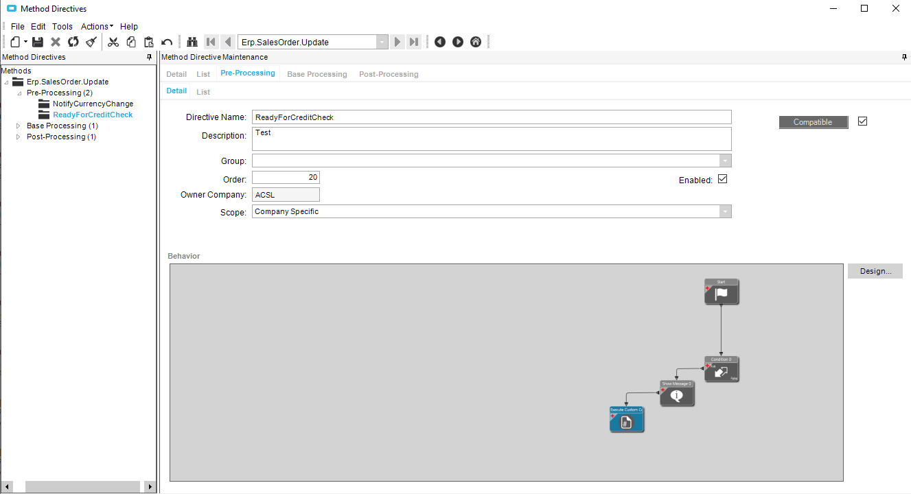

I have used this in SalesOrder Update function using Method Directive.

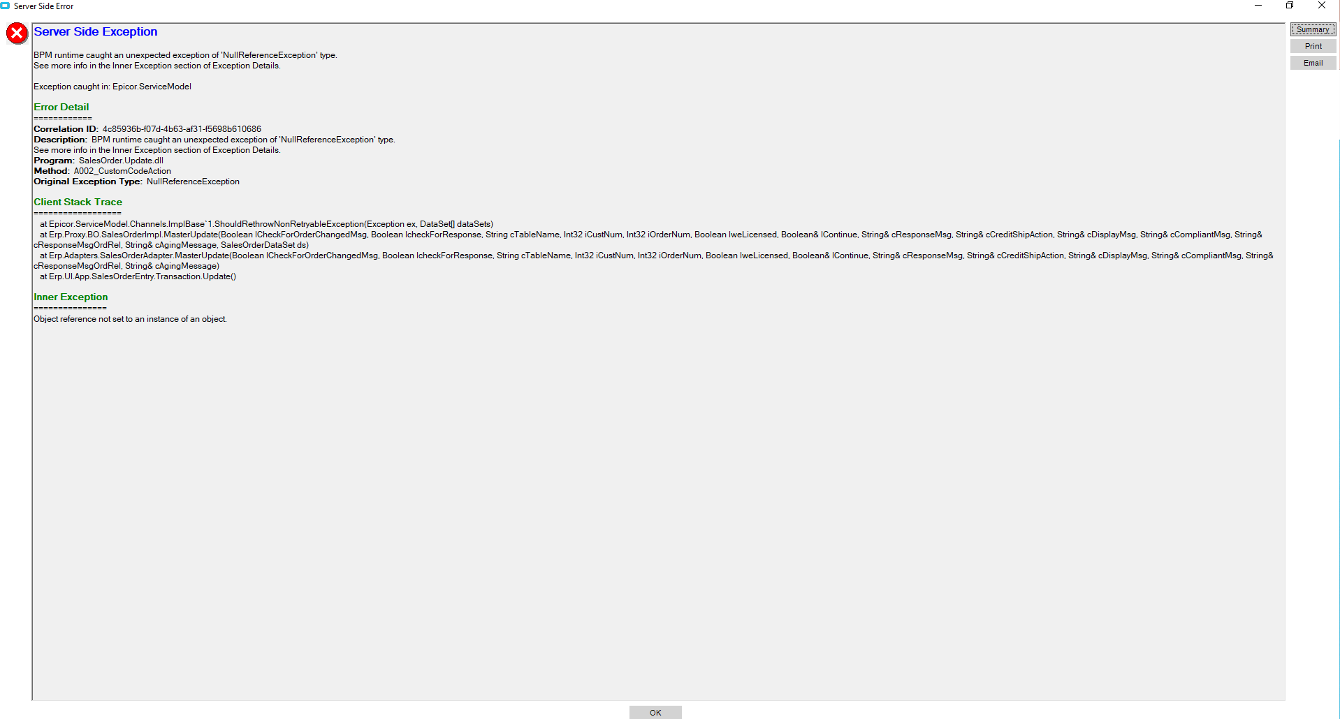

When I save any record, it throws this error right away, it does not even show the Message Box that I have in the custom code, without that section we added together the code runs fine.
Something seems to be Null for some reason…
This is also in case required. I hope this is not totally wrong :stuck_out_tongue:
I’d start commenting out sections of code from the bottom up and see where it fails.
It fails here
CMOrderHedRow ordersToRemoveHoldFrom = (from ordersOnHold in CMTs.CMOrderHed   where ordersOnHold.OrderNum == ordernum select ordersOnHold).FirstOrDefault();
You’re not matching on any orders, which means we didn’t pull something correctly,
or your orderNum is wrong
Anyway, need a null check there :slight_smile:

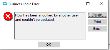

CMTs = CMsvc.GetOrders("THIS IS SUPPOSED TO BE CUSTOMER ID NOT CUSTOMER NUMBER");
Hey that worked!
The CustID thing resolved the issue that I had and now, of course, another issue, it says the row is being updated by another user.
This order is isolated and I am testing it on a Test environment so no other user is accessing it:
Is it due to changing the RowMod to “U” ?
Credit override is done though, no problem there
So basically what happens is that the Credit Override happens but then no other change takes place.

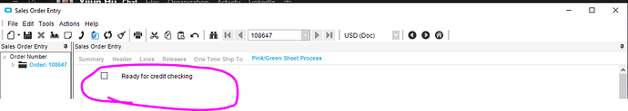

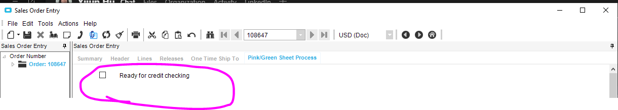

The process happens if a checkbox is checked and then the BPM kicks in, now that same checkbox that triggered the process does not remain checked after the error pops up…
:frowning:

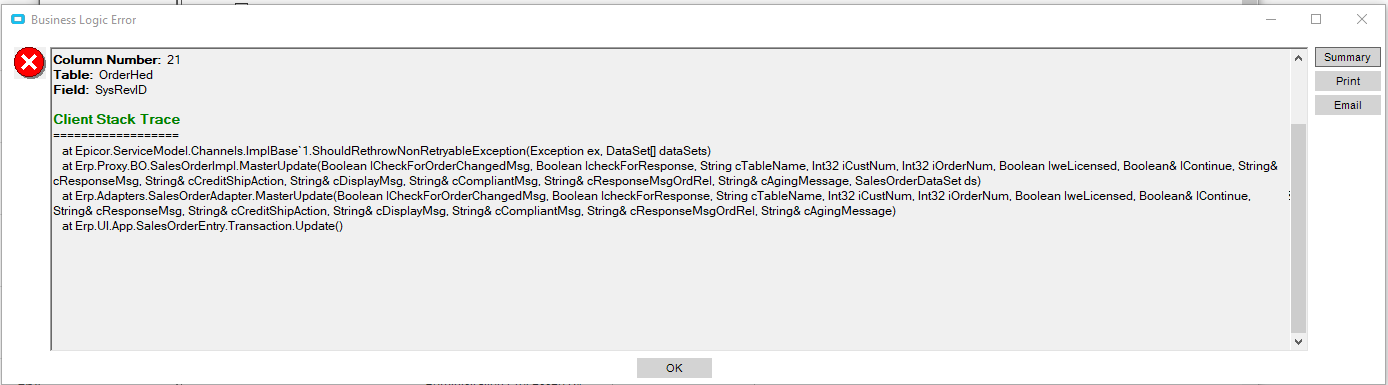

It does not throw that error anymore but still does not keep the checkbox checked…
:frowning:

No actually I need the checkbox to stay checked and that is the start of our process for credit checking.
Our sales team checks this checkbox, if it has to then it will be auto-released (you saw the logic in the code), if should not be auto-released then the Accounting department has their own dashboard that shows what is checked for credit checking (that checkbox) that its credit is not overridden.
Also one other issue with this is that if the user updates other pieces of information, for instance PO# or dates, those also won’t be saved.
I think you’re going to have to do it in post or trigger some other way.
When you save, you have changes.
Then the credit process also makes changes.
Now your changes are stale, even if we pull the updated record, the original changes need to be applied. Sounds complicated.
I’d pull that last bit of code I added out and move it to post if you can.
