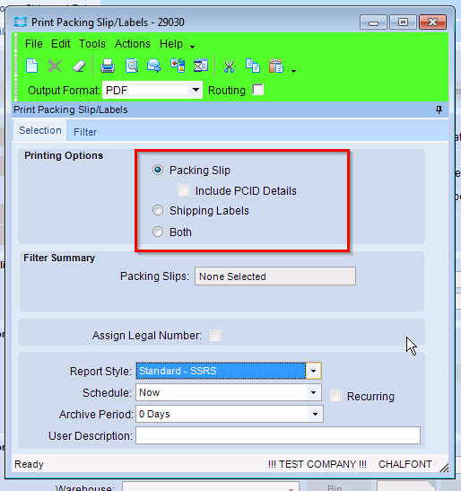

I’m completely unfamiliar with using Manifest, but the “Print Packer” dialog gives you the choice to print Packing Slip, Labels or Both.
Do these Labels not meet your need?
