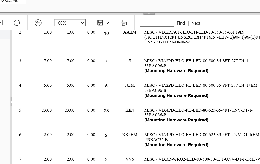

So the question is how do I set OrderLine_KitParentLine field to be equal to line numbers?
I did a test and set them to OrderLine_KitParentLine = OrderLine and did a print on browser and it shows all lines. How can I make Epicor generate the correct OrderLine_KitParentLine numbers?

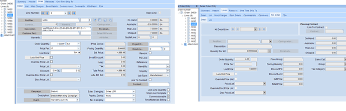

If you go into the order, Re-open it (and the lines and releases), then go to line 3, and see if anything shows Lines -> Kit Detail
Also, there are several OrderDtlFields that have to do with Sales Kit lines (or their components). Look at them in the SSMS.
Samm
(Arash Farmagham)
November 4, 2020, 8:23pm
23
Kit Detail is blank! I think someone has messed up with this order early on…

If you just need to print the packer out, maybe tweak the RDL’s query expression to force the Kit related fields. Something like:
..., null AS 'OrderLine_KitFlag', T2.OrderLine AS 'OrderLine_KitParentLine', ....
Samm
(Arash Farmagham)
November 4, 2020, 9:02pm
25
Yeah that’s what I did! Thanks a lot for your hints and help!! You’ve been extremely useful!
