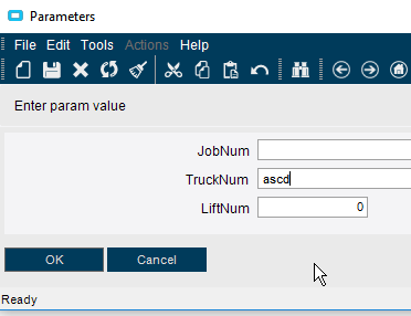

Parameter skip if empty
Try 0(8)?
No joy…
It lets you type it, but does it get mad when you click OK?
yeah, type mismatch. Same if it’s x(8). If I put a number in there, I just get a warning that there could be a type mismatch, but it works.

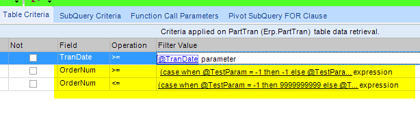

  1. Make the Param an Int, with default value = -1
  2. Add two table criteria with the field >= expression and the field <= expression
  3. The expressions should be:
    (case when @TestParam = -1 then -1 else @TestParam end) for “>=”
    (case when @TestParam = -1 then 9999999999 else @TestParam end) for “<=”
