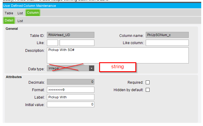

Sadly, I tried that… it also keeps coming back with a zero.
Make another UD field named PkUpSONumTxt_c, of type text.
And us a DD, BPM , or UI Code to convert the value of PkUpSONum_c to a text string for PkUpSONumTxt_c

The standard Epicor fields for Sales Order use a Text fields, so like @ckrusen suggested.
What if you change the Format from >>>>>>>>>>>>>>9 to >>>>>>>>>>>>>> ??
Couldn’t the SO number simply be a string? It’s not like you’ll be doing any math with it right?

Did you remove and re-add your UDField so it’s a text field instead of a numeric field?
That is a good point from Brandon…
Delete the original ud field regenerate all and recycle…(or put back it’s original type…and dont use it…)
Then add a new UD field nvarchar.

I did add new UD fields, I’ve never gotten the type to change on existing UDs.
