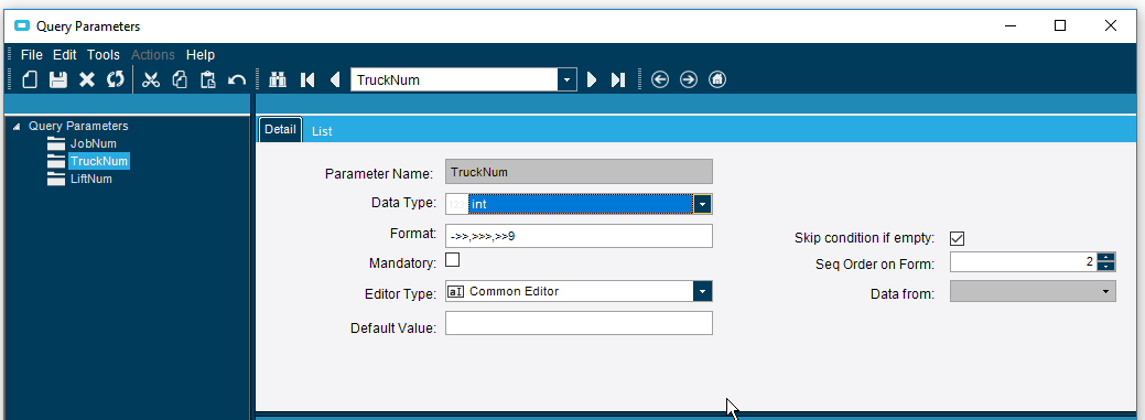

Does anyone know how to allow an empty field on a decimal or integer parameter? If the user tabs through the field, it will put a 0 in there, which obviously messes up what they are trying to filter if they don’t want to use that parameter.

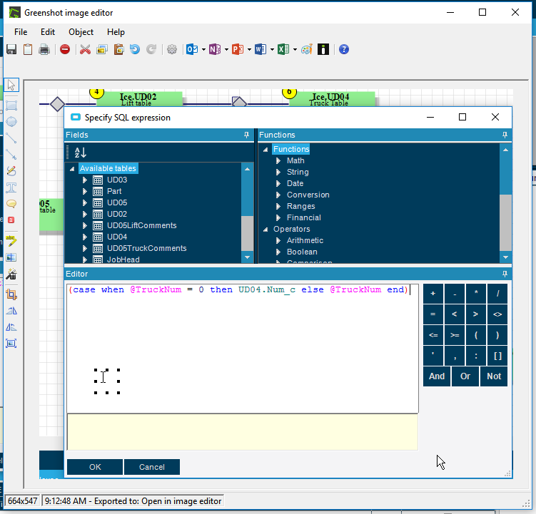

Could set the default value to zero, then in the criteria for the table make the parameter equal to the an expression. Inside of the expression make an if statement that says if the parameter equal zero then zero else shiphead.trackingnumber. That way if it is a zero it is true but if they enter a value it does the comparison.

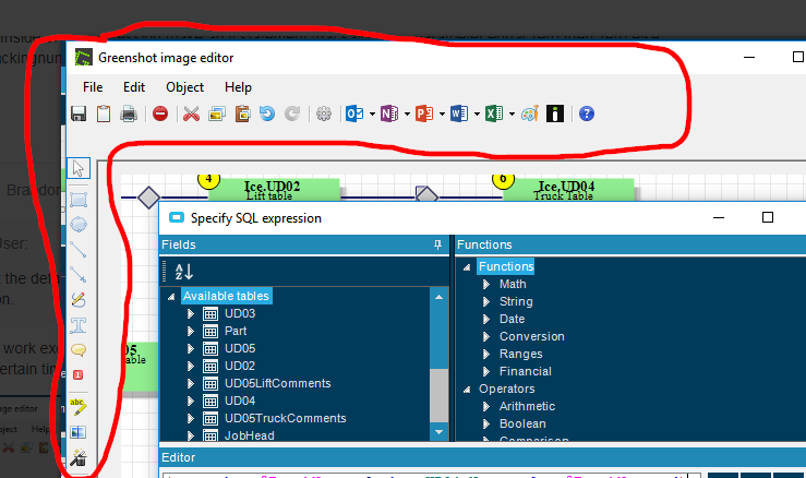

And did you take a screen shot of the screenshot?
:slight_smile:
should it be:
(Case when @TrackNum = 0 then @TrackNum else UD04.Num_c)
This way if its a zero then it will always be true, it will only look to do a comparison if a value is entered.

Not sure what you are getting at with this one. If I put that in the expression on the criteria, it will replace the criteria with the value of the field if I put something besides 0 in the parameter. If someone puts a number there, they want to filter it, and I don’t want to replace the parameter value.
yes… yes I did. :man_facepalming:
Are you new to Epicor? :wink:

One last thing to try. Change the format from ->>,>>>,>>9 to >>>>
I assume your Truck numbers aren’t negative, or have commas in them.

It still puts the 0 in there.

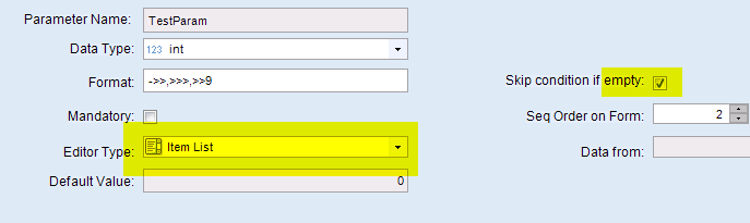

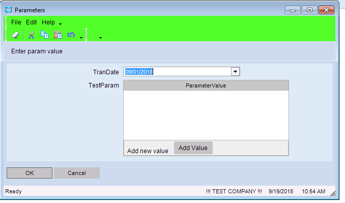

I think I got it! (not pretty but works)
Make param an item list
And make criteria use IN
I’m sure it is because the field is not a nullable type. Not that it really helps, but at least provides an explanation.
By “not pretty” I mean the input param looks like:
But does return all records when TestParam is left blank.
And gives you the added feature* of allowing multiple TruckNum’s to be entered.

The list thing is an interesting workaround too. I’ll keep that in my back pocket.
