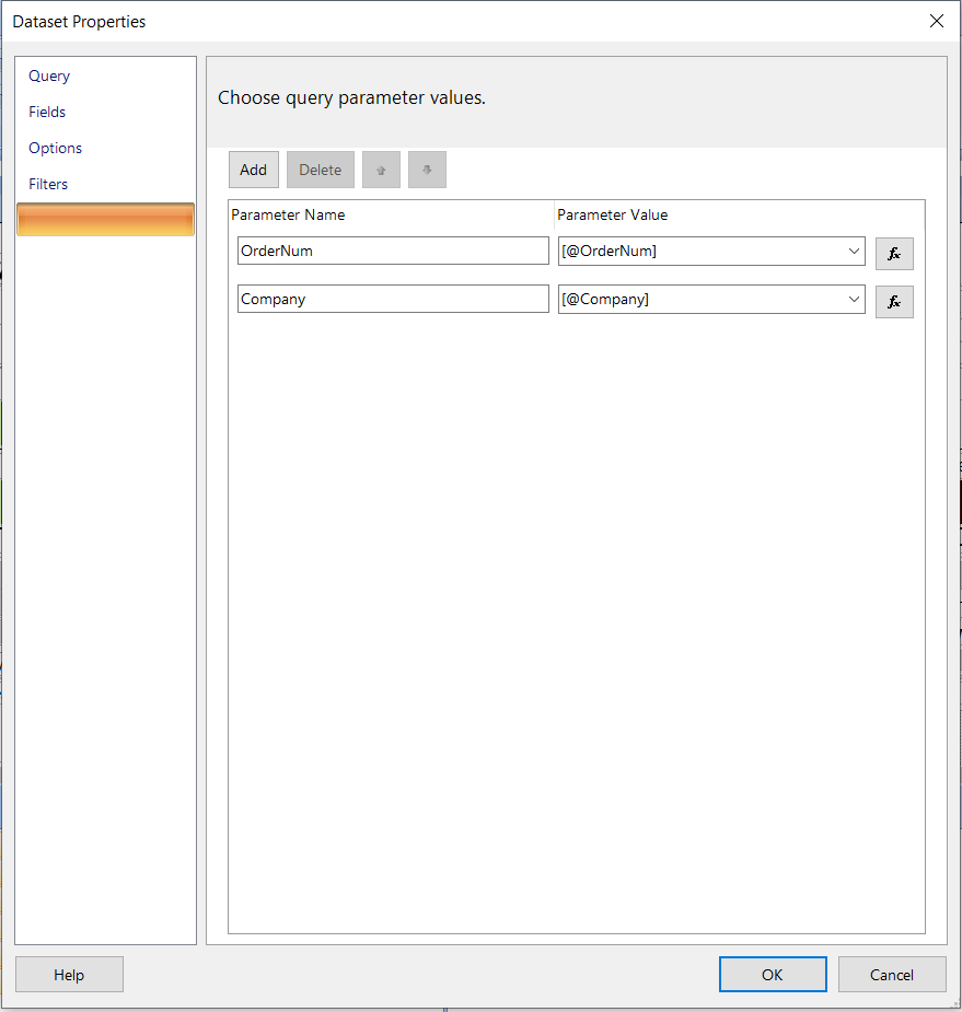

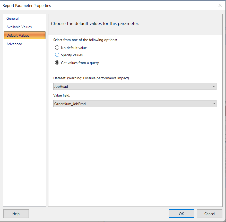

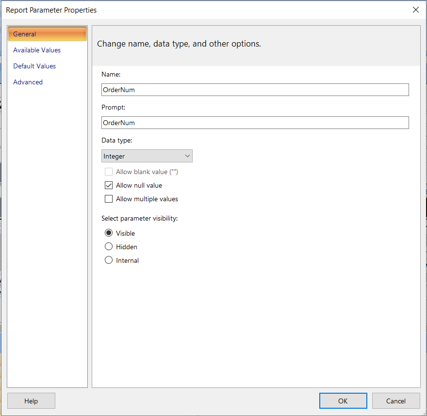

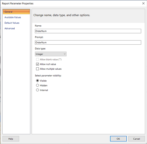

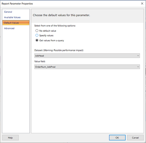

I have a parameter [@OrderNum] in my Job-Traveler report which I’m using as a filter for a UD field. Everything works fine when I print one report but when I try to print multiple reports, the first report is ok but the subsequent reports take on the parameter value of the first report and as such repeat information from the first report. Can anyone advise me on how to correct this? I have attached images of the [@OrderNum] parameter properties. Thanks in advance.

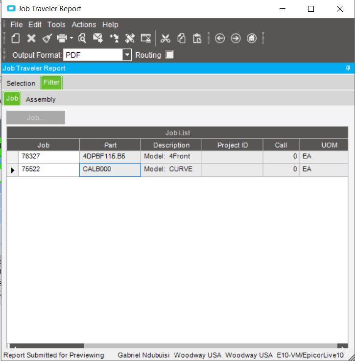

My operations people wish to have the option of printing more than one Job at a time. They can print the Jobs one at a time and there is no problem when they print this way but they want to have this option where they can send to print 2 or 3 Jobs at a time. Can this be achieved?

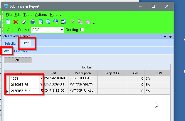

The Filter tab on the Job Traveler report doesn’t do what you want?
Either search for the jobs with the Job… button, or click the new Icon on the tool bar and manuallyenter

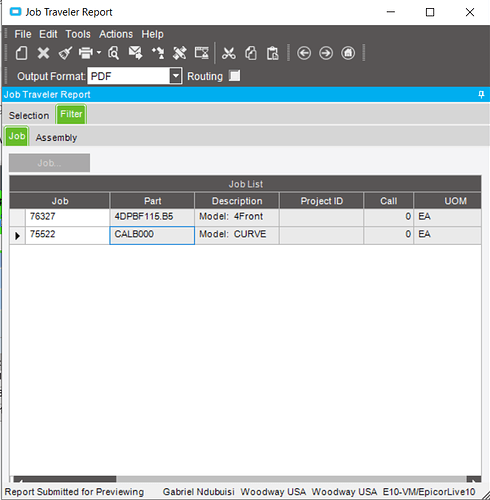

I’m using this dialog to select the multiple reports. When I click “Print Preview”, it prints all the reports as one which is ok but the “Shipping Option” field is the same for all the reports whereas it is supposed to be dynamic.

What are you doing with the parameter value after it has been set?
Why not just use JobHead.OrderNum_JobProd in place of the @parameter?

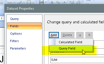

You added the UD field to the RDL’s query expression AND added the query fields?
A couple of times I’ve accidentally clicked on “Calculated Field”

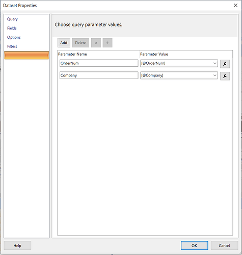

After the @OrderNum parameter is set, I use it in the ShippingOption dataset as below:

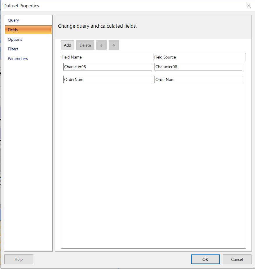

Below are my “Shipping Option” dataset fields. After creating the Stored Procedure, the fields where automatically populated when I created the “Shipping Option” dataset. The UD field is Character08.
