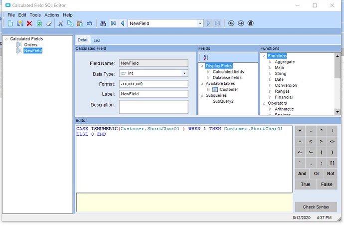

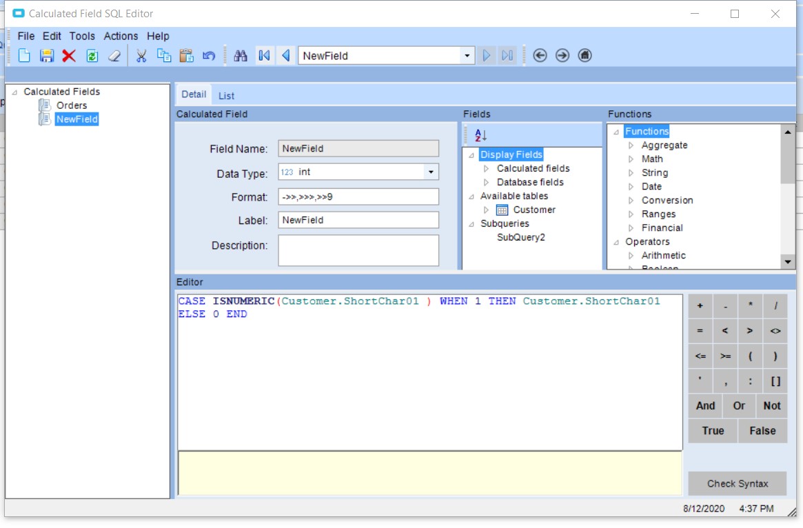

You can try a few things.
One way would be a calc field.
CASE WHEN ISNUMERIC(ParentLot_c ) THEN ParentLot_c ELSE 0 END

You will need to create a custom calc field.
Then use the new custom field where you are doing the join PODetail.PONUM = PartLot.ParentLot_c
And you’ll change LotNum to your UD field ParentLot_c
Greg

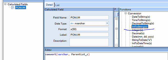

make a calculated field converting PONum to nvarchar
Join using calculated field

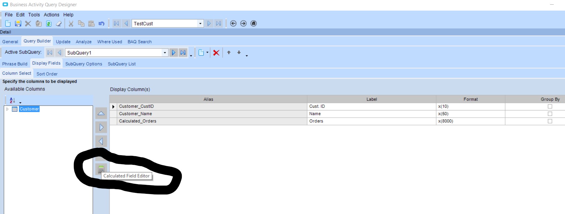

Ken, I’m not sure how to accomplish this:
You will need to create a custom calc field. But to be clear is the Calc field using the “convert” parameter?
I understand how to create a Calc field but I do not understand how to add it to a Join unless one of the tables are in a SubQuery?

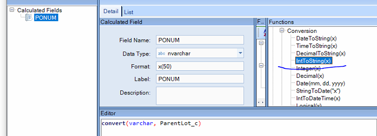

Adam - sort of the same question, I’m not sure how to add the convert(varchar,PONum) - and I’m not sure what you mean by:
change LotNum to your UD field ParentLot_c?

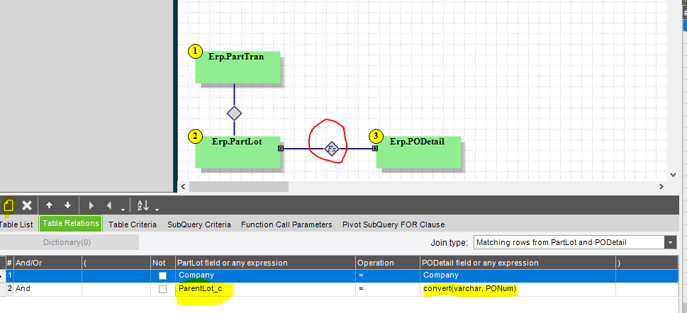

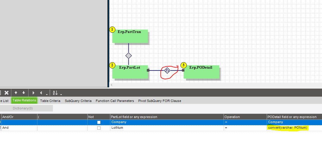

I tried to remake your query in the screenshot, but since I didn’t have your UD field ParentLot_c in my database I used LotNum instead. I meant for you to swap out where I had LotNum in the join and put your UD field ParentLot_c:
For the convert part, I just created a standard table relation. You’ll select your PartLot.ParentLoc_c field from the dropdown like normal. You also have the option to enter an expression in those text boxes (See where it says PODetail or any expression).
So for the PODetail field in that table relation, you can just paste in:
convert(varchar, PONum)
Calc Field using the Calculated Field Editor.

Hey Adam - sorry for the delay, in responding to you. I have what you have but am receiving and error
Text: Ambiguous column name ‘PONum’
Am I missing something here?
Thank you again for your help and patience!
Edit
Apparently you can use the conversion in the table relationship. It just needs to have the table name too (see next post).

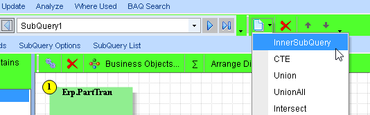

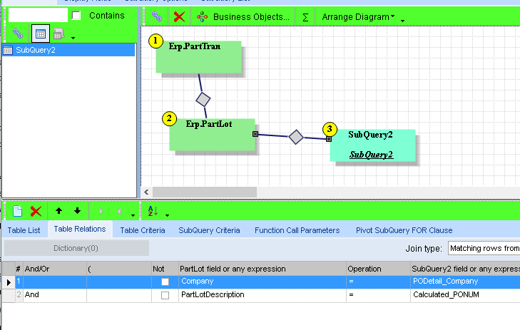

You’ve been misguided by the fact that the Calc field is a result of this subquery. Therefor can’t be a field in a table relationship in its own subquery.

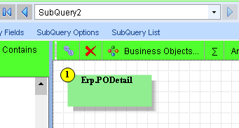

  1. Create new subquery of type InnerSubquery.
  2. Add the single table PODetail (it will warn you that it’s in use - that’s okay, it’ll add a “1” to the table name).

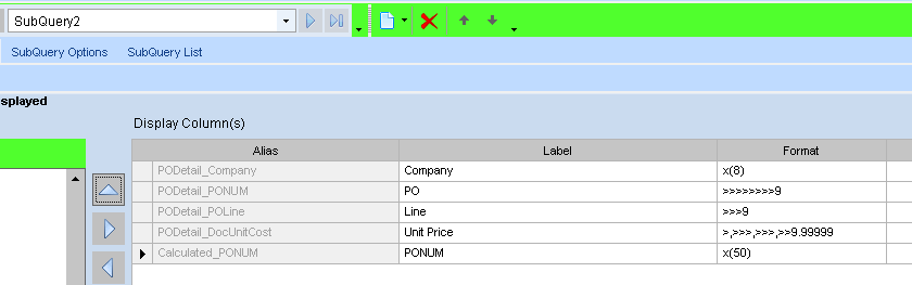

  3. Add all the fields you want in displayed in your top level subquery
  4. Add a calc field like @gpayne said.
  5. Now back in your top sub query, remove the PODetail table.
  6. Add the subquery2.

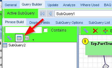

    (Click here to show the subqueries)
  7. Now add the relationships between PartLot and subquery2
I didn’t have the UD field you do, but as anexample just made the relationship to another character field of PartLot.
try including the table name, like:
convert(varchar, PODetail.PONum)
